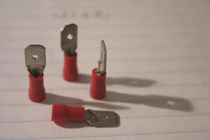

Ok, thanks. What about the adapter though? Can I just strip the wires and wrap them around the prongs of the speakers and then electrical tape them?
Old Feb 15, 2012
got2run5's Avatar
Joined: Feb 2011
Posts: 460
From: Midwest
Rep Power: 190
got2run5 will become famous soon enoughgot2run5 will become famous soon enough
Re: sufficient bass with upgraded speakers?
No way. Get some correct connectors from your local hardware store. There is a DIY for front speakers floating around here somewhere that will show you how to wire stuff without ruining the stock harness.

Here's the picture of the crimp-type connector that I bought when I worked on for my speaker cable that I use for my rear speakers.
Basically, This one is 1/4" wide. I probably need someone to confirm since I sold the car already. This fit the hole of the Honda speaker connectors and on another side of the wire, you can crimp the female connector so it can hold to the speaker terminal. Crimping is fast so I recommended.

You also don't need to buy harness adapters. You can make your own. Look at the DIY for front speaker install and that shows how to make your own. And 1 inch spacer should probably work for the fronts. If it doesn't, go with a little smaller or you might have to cut some plastic.
