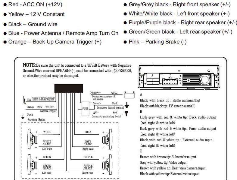

This may help
Name:	Wiring Diagram.jpg

Yeah, there's only one sub pre-out. Its' brown with a brown tip (as noted in the diagram). I didn't connect anything to it because there was only one, so I just connected it to the RCA pre-outs in the back of the head unit.

I think I know your problem, you have a mono sub out, and your amp is stereo input
You shud have a mono switch on your amp, im assuming

If you connect to the preouts that are not the sub out, you are possibly sending a full signal to the sub. Now I say possible as the high pass filter may be set cutting off the lower frequencies. I would also assume that a regular preout does not pass frequencies below 50Hz as to not damage regular speakers (but I could be wrong on that)
Anyway, you do not want to connect your sub amp to those outputs. Get a Y adapter and only use the brown RCA. You should notice a huge difference in the sound. And your sub control on the headunit will actually work.
Right now the only sub control you have is the bass level and that will increase the bass going to the rest of the speakers possibly damaging them if you turn it up all of the way to get the sub louder.

Alright I'll have to give the Y-connector a shot. Never considered that, actually. No mono switch on the amp. Just a master/slave switch and a phase switch.
