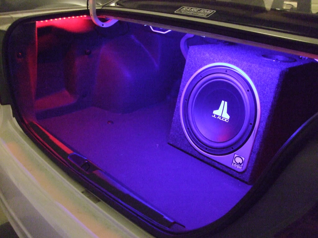

There is an adapter behind the dome light (You might have to take apart some of the roof to access it)
Plug the positive end of your lights to the positive of the adapter, same for negative
Depending on how you do it, you can have your original dome light on, or off
I did this to my trunk light and LED's turn on when trunk is open
Let me know if you need more help on this
