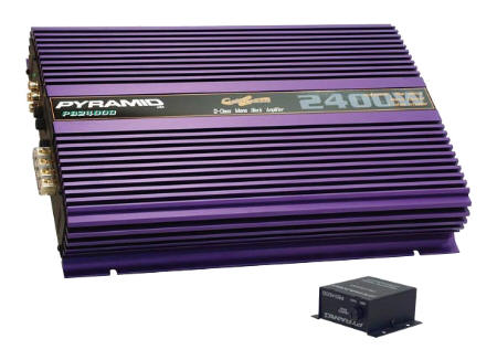

So to clarify.
You are stating that it would be acceptable to install a 100W amp this way?
I am talking a true 100w amp not a legacy. Also if so, how many watts would you put threw the factory wiring?

The pic of the pyramid gold was just a joke.
