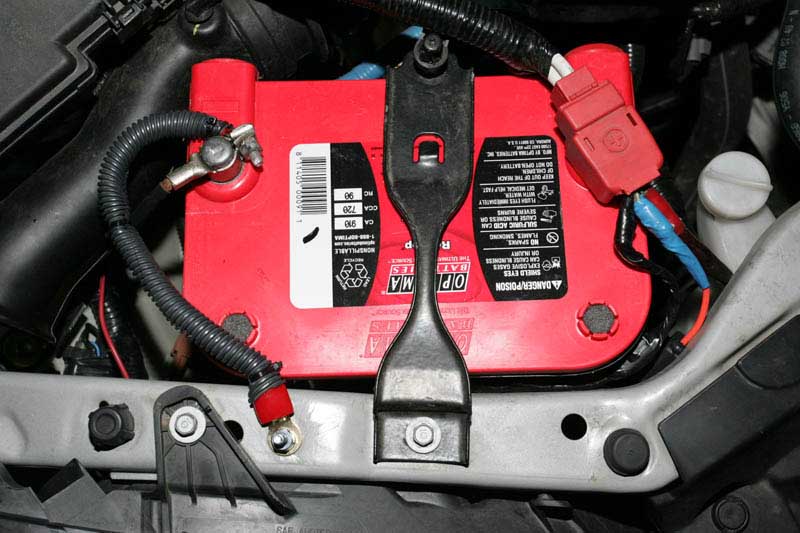

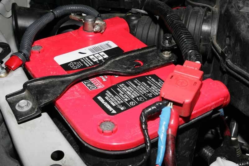

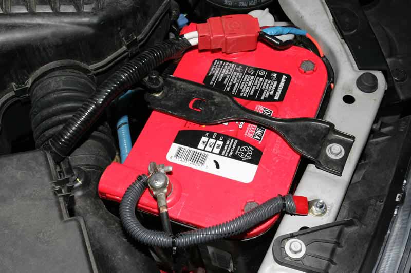

Today I have bought Optima Red Top 75/25 size battery, and want to share some experience on its installation. Unlike what other people say regarding a matter that this battery is bigger than stock 51 size, installation is EASY and requires almost no modifications.
So here is a deal.
1. Take your stock battery out, along with its tray and plastic box. They will not fit new battery.
2. Take tie down bar and flatten out a notch that holds stock battery. It is pretty thin, I just place it on a concrete and used a small hammer to flatten it out.
3. Place your new Optima battery in place, and install tie down bar after u turn it 180 degrees.
4. That is it !!!!!!!!!!!!
5. EASY !!!!!
Any questions , or for photographs e-mail me at: pashenka18@hotmail.com
See you !
