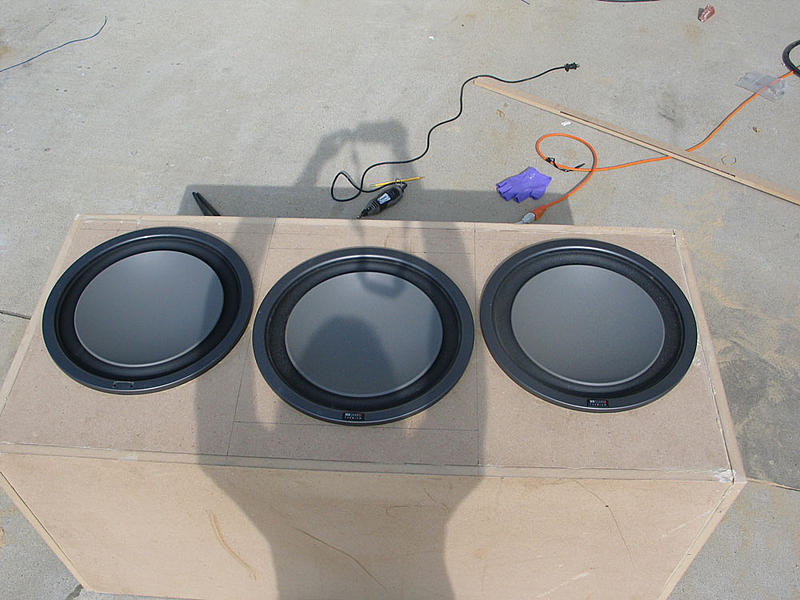

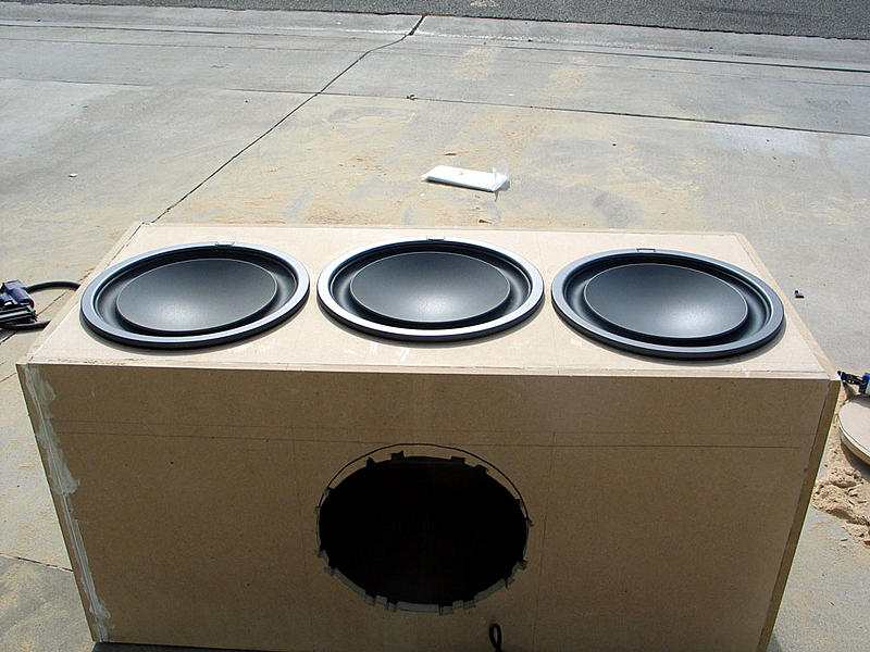

heres a pic

whats that big *** hole on the bottom for?

thats the 4th sub... but i didnt screw it in yet

Looks like some potential cancellation issues.

Please explain ...

i wouldnt do that. close off the bottom and run 3 subs if you dont have room to put all 4 in a row. or make a seperate box for the 4th and put it somewhere else.

Because the subs aren't all in the same plane some of the sound waves can cancel out with each other likely resulting in deconstructive interference. When all drivers are in the same plane they will create waves at the same point and these waves will be in phase. The waves created by the lone driver will not be in phase with the waves created by the other three. The intermingling of these waves can cause bumps and dips where they shouldn't be thus altering the sound.
