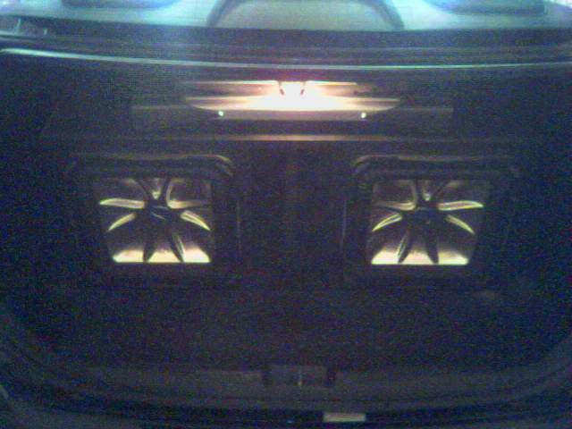

I have 2 L7 12's in a ported box powered by a Kicker KX1200.1. It is LOUD!!!! I dont know if you are familiar with decible and hertz levels, but it hit 145.2 decibles at 66Hz in my 02 Coupe.
And Kicker isnt outrageously expensive. By the way the new Kicker amp that is comparable to mine is the ZX1000.1. If you want pics or anything hit me up.
