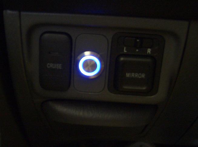

Step 4: Mount switch
Wherever you decide to mount the switch, whether it be in a completly custom location in the dash, or a spare panel like I did, you must prepare the spot where you will install the switch.
Use a small drill bit at the center of where you would like the switch to make a small hole.
From there use the hole cutting bits to get a nice circle. Always cut a tiny bit smaller than the switch can fit it.
Sand the hole with the dremel and sanding drum until the switch fits in snugly without getting stuck.

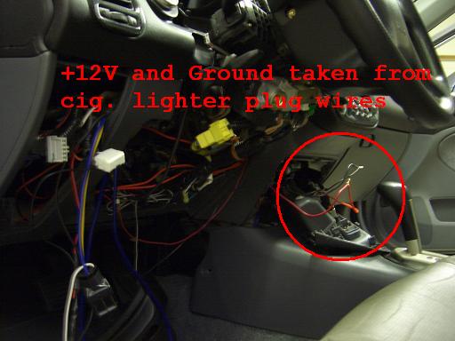

Step 5: Prepare Car
Remove the screws underneath the steering wheel column. They are on the bottom of the plastic cover that is right behind the wheel. Once you have the screws out, the top and bottom cover pieces snap apart and will come off. Just give it a little muscle and it will come off easily.
Also remove the lower dash panel by turning the two ***** and pulling it off.
The last place you need to get to is wherever you are installing the switch. If you install it where I did, you should already have that panel out and the switch in place.

Step 7: Install I
Start by attaching all of the wires to the switch from the previous step. I recommend putting heatshrink on the wires just large enough to fit over the connectors, attaching the connectors to the switch, and heatshrinking over each connector. This way if the tabs get bent in the car, the switch will not short out and break or try to start the car on its own.
Install switch into place.

Once you have the switch in place, you will want to get power and ground to the switch. I used power and ground from existing wires taken off the cigarette lighter plug. You may use these wires, or you may want to ground to the metal near the switch and take power from the 'accessory' wire in the harness we will work with later.
After soldering and taping these 2 wires, attach ground cable back to the battery. Turn the car to 'on' and hit the switch. Make sure the switch activates the relay. If not check all connections.
Disconnect ground from battery once again.

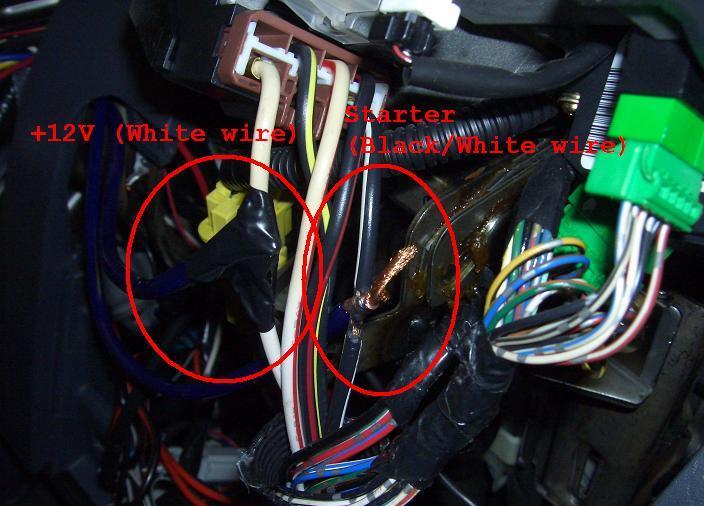

Step 9: Install III
Now is the tricky part. You must attain +12V and Starter connections to the relay. To do this start by looking for the White wire, and the Black wire with a white stripe, behind the steering wheel. They will both be coming from a brown plug. The white wire and black/white wire are both thick wires.
Once you see which wires they are, you must remove the shielding from them in one spot. DO NOT CUT THE WIRES! Just take a knife and slowly remove the shielding until you have about 1/2" of the wire exposed. When both wires are ready, solder the corresponding wires from the realy (doesn't really matter which is which) to the white and white/black wires.
As you can see in the picture, I used a lot of extra wire which was cut off after the soldering was finished. Remember it's always better to have too much than not enough!
Make sure you solder them on extremly well, and make sure you tape them as much as possible! This is crucial. You will have about 30 or 40 amps running through these solder points and you DO NOT want this to come apart!

02cvcEX will become famous soon enough02cvcEX will become famous soon enough
does that blue ring stay on all the time? or just when you turn on your headlights
Old Apr 18, 2006
diskreet's Avatar
Posts: 8,839
From: PA
Rep Power: 362
Once the key is turned to accessory I, II, or On it is lit.
