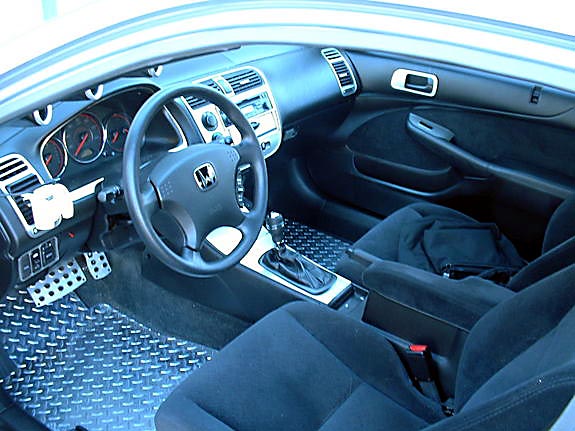

mine plugs into the headphone jack
i put the ipod in the holder all the on the left of the pic in the air vent

ok well i can see the chrome being a bit much for some people but i like it and the holder is in the second picture i posted so u must be blind if u dont see it, i even said " IT'S ALL THE WAY ON THE LEFT IN THE AIR VENT" which its right by the wire. I bought the holder for $10 and it works good enough for me and i wouldnt want to make one cause it would look really bad, oh and the gauge pod, one is volts cause i went through 3 batteries already and i had the car not even 2 years, and im going turbo soon so when i saw the gauges for cheap i bought them, is that a problem?

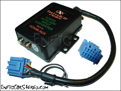

ok well this is what i have now, cause i still have the stock cd player

i would have to get one male and one female rca connector right

for the adapter u showed, u'd get 1 cable thats male rca to male rca, then 2 barrels (the female to female), then a male ministereo to male rcas.
