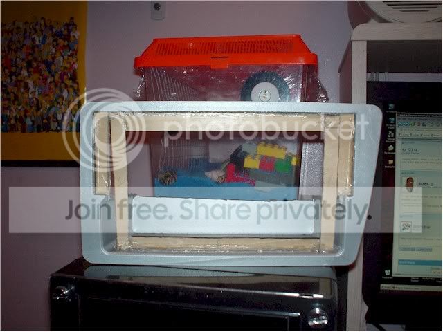

okay so my screen looks like this.
I want to make it flush kinda, so their isnt any of those gaps and it looks less ghetto.
So i assumed all i had to do is make a frame for the screen and fill in the depths with bondo?
Is this the right way to do it?
here are some picture sof my progress.
Is this the right type of bondo to use?
THanks for any help you guys cna give me! i never did any bondo before!

well i tried my best!! this is my first time doing anything like this.
HELP!!: I cannot seem to get it as smooth as i like. with the High Fill primer on it, i can still see the scratches from sanding and some of the uneven levels of the bondo. What am i to do about this? How do i make it smooth?

Thanks for all the tips guys, I fixed it by sanding it down big time and filled it in neatly with bondo. THe problem before was that i didnt have a sanding block or a plastic spreader for the bondo. LOL
well its nice and smooth now. thanks!
