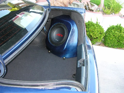

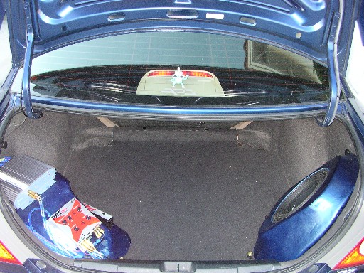

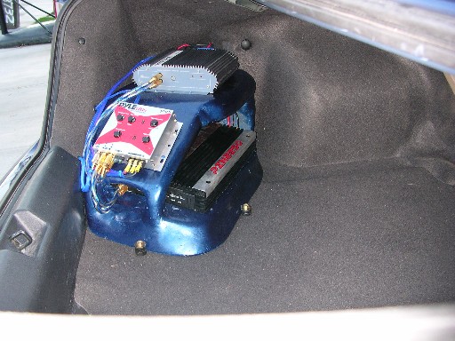

After 2 weeks of being lazy, i have finally finished my fiberglass sub enclosure and amp rack. it, by no means, has a show quality finish, and it looks kinda shitty, but its functional.. it was my first time.. and i didnt wanna finish it with cloth because it woulda been waaaaaaay too ****ing hard to cover the amp rack with fleece..

i used the DIY.. taped off my trunk, layed down fiberglass resin and fiberglass mat to form the mold. the sub enclodure is fleeced and the amp rack, well, yea.. i used prolly the 2 thing i shouldnt have used to mold it: styrofoam and duct tape
when i found out what fiberglass resin did to styrofoam and duct tape (****en eats styrofoam and distorts duct tape like mad), i fleeced whatever i could and layed down masking tape on whatever i couldnt, then layed down more fiberglass resin and fiberglass mat. after i got something that i could work with, i used wood filler and later on body filler to fill in holes and stuff.. also found out that using an electric sander sucked on body filler and that sanding by hand was a **** ton better. that amp rack is still strong enough to stand on

i agree with the fleece thing. the sub box would have been easy to fleece. the amp rack, on the other hand, would have ended up looking worse than what it does. too many curves and holes and whatnot. either there woulda been small gaps or layers of fleece overlapping. the fleece isnt thin either, so it would have been noticeable where i cut up fleece to make it fit.
