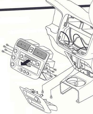

  • Installing a new Head Unit
  • For reference I have included a helpful pic below this list!!!
  • First remove the lower center trim piece with the 12v cigarette lighter. Unplug the wire going to the outlet.
  • Look into the area behind the panel you just removed. Directly upward are 2 screws holding the Center Console piece with the A/C controls and stereo in. Remove these 2 screws.
  • With a trim panel remover or flat head screwdriver covered in cloth to prevent scratching, slowly pry away at the bottom corners of the console piece that we are trying to remove. The first time this can be very hard to do but any times after that it will release easier.
  • Remove the antenna wire, and all wire plugs going into the stereo and buttons.
  • Remove the 4 screws on each side holding the stereo in place.
  • Mount the new reciever as per the mounting kit's instructions into the mounting kit. Screw the kit into place using the 8 scrwes we removed earlier.
  • Take the wire harness that came with the stereo and the honda wiring harness plug thingy that you should have bought, and wire them together. For the best connections solder the wires together after winding them together. Tape over with electrical tape, duct tap, or use heatshrink.
  • Plug the new wire harness into the old plug that is IN the car, then plug the other end into the new stereo.
  • Plug the antenna wire into your new stereo. Check all functions before continuing.
  • If everything works normally, re-assemble the console in the revearse order that we took it apart.

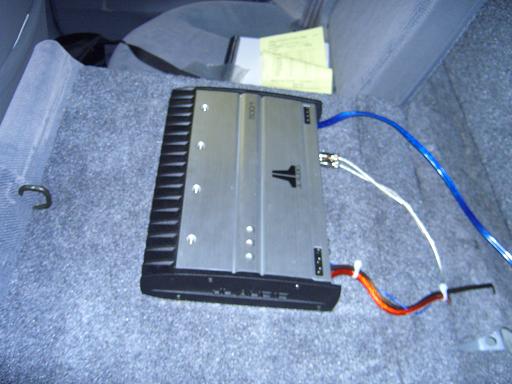

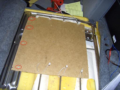

  • Mount your amplifier. If you want to put it to the back of the rear seats take a piece of fiberboard and screw/zip tie it into place (as in my pics). TO PREVENT RATTLING KEEP A CLOTH OR SOMETHING BETWEEN THE WOOD AND METAL BARS. The seats just unzip on both sides to gain access to them like this.
  • Screws are circled in red.
  • Zip the cloth back up, and screw your amplifier down to the wood through the fabric of the seat back.
  • Connect the amplifier turn on, power wire, ground wire, then RCA wires (in that order if you would like to, doesnt matter too much)
  • Connect your speaker wire you your amplifier, then connect it to your subs/speakers.
  • Check all connections, put everything in its place, reassemble the console. Make sure nothing is pinched.
  • Put the fuse in the fuse holder under the hood.
  • Enjoy your new subs/speakers. Just go easy on them for a few weeks, no loud music, or they will not break in properly.
  • Look good?
