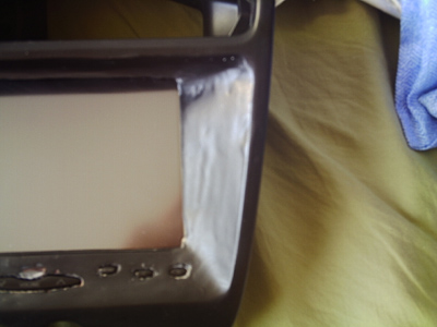

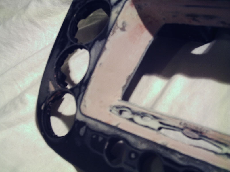

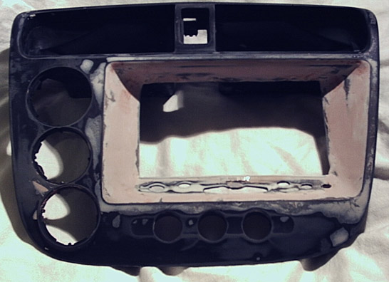

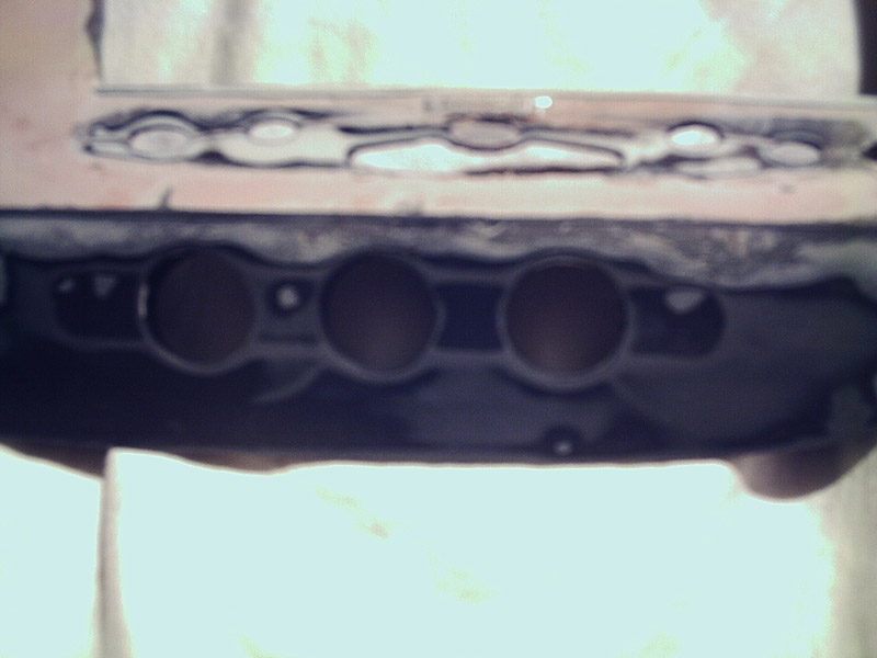

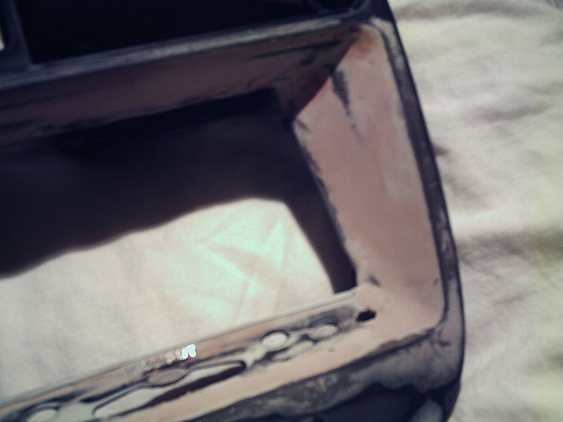

here are some pics...just finished:
Step1: Cut
Step2: Bondo Hair
Step3: Bondo body filler
Step4: sand
Whats step 5? i heard something about a putty?
Step 6 should be primer? then sand then primer than sand?
step7 should be paint? what color should i use to match the oem? what grit should i use to sand in between?
im going to be making a carputer but till thats done ill just hook up the xbox for now...

Yup, polly putty will fill in all those nasty little crevaces that will make your paint pop. You wanna sand that **** with like 320 and 500 though.
Old Apr 13, 2005
PopcornPlaya's Avatar
Electric Boogaloo...
Posts: 4,457
From: Want to play a game?
Rep Power: 330
The "putty" is a glazing/spot putty. It's used to fill very minor imperfections/air pores created by sanding. It's used to fill the minor stuff. I'd recommend sanding with between 300 and 600 grit sandpaper until you get a uniform surface. From there, put on one thin layer of the putty and let it dry. After it dries, sand lightly with said paper to knock down the high spots, spray a layer of a light colored primer (I prefer white or grey) onto it. After the light color dries, get a contrasting color (I like flat black paint or black primer) and spray a mist over that coar. Sand lightly until you have a uniform surface again. The places where the mist is left over are low spots. Continue this process until it's all even with no high places. Finish sand with 600 grit and paint (anything finer would smooth it too much and make the surface sort of waxy, the paint won't stick as well to something that smooth).

dremel is your friend =)

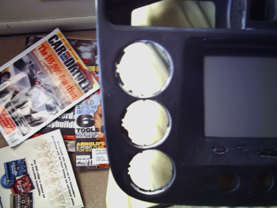

do i sand at all after applying the first layer of paint?

Yes, you actually want to remove most of the base coat to remove all forieign partcles the paint picked up. From there, with every layer, graduate the grit on the paper. After your last layer of clear, sand with 2000 grit paper, wipe free of all debris, put on a thin layer of finidshing compound, and buff off. After that's done, go back over it with a layer of your favorite wax. It'll shine like a new penny...

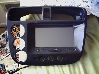

granted this is my first time working with bondo/fiberglass but i gained a lot of experience from this project and the next fabrication is guaranteed to be better than this one (i sorta rushed the painting on this one)

The video doesn't show the work at all. Just the screen. I'm a little confused, the pics above are not your finished product, are they? If so, then either my eyes are playing tricks on me or you couldn't possibly charge anyone for that. It looks all wavy and choppy. Plus, it looks funny that you didn't try to level out the two sides with fiberglass in order to acheive a balanced look. I do not mean to offend you, and if that's your first time using fiberglass you did pretty good - but you can't charge people for work like that IMO. Again, unless those either are not finished or look different than the project does in person.

i kinda like the sides....it kinda has that factory look
