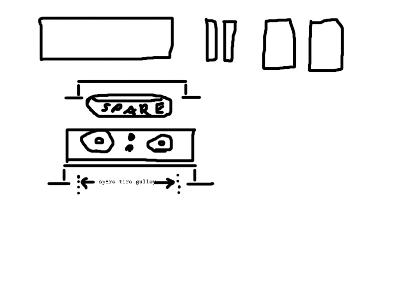

cut a piece of wood as wide as the cardboard stuff is(add 1.5 inches) then cut a few pieces like 2 inches tall and a few more like 3-4 inches wide. put them together like in this pic.
then mount your woofer box on top of the board in the middle. now your woofers will be an inche or 2 above the cardboard and youll be able to move the cardboard to get to the spare. or you could go into soem crazy stuff mounting it upside down in the rear deck but more angles and geometry involved in that cutting.
