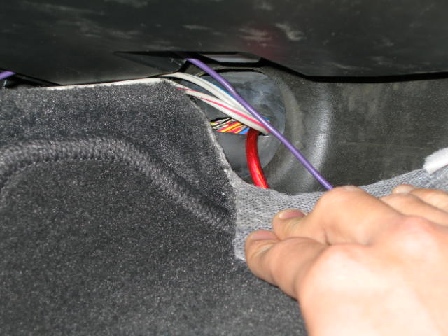

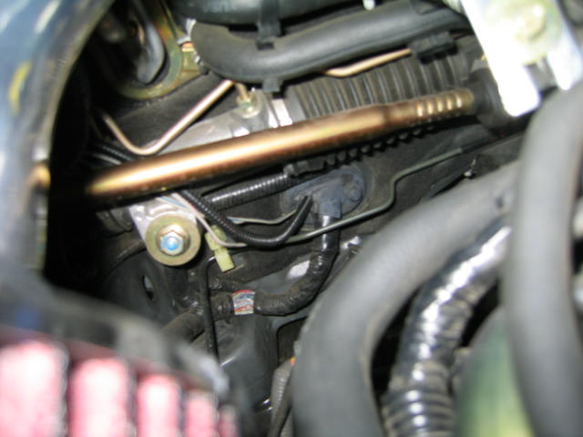

*Sorry but I don't know where to host these pictures.
Grommet:
From the engine bay. Where the intake area is, just look straight down and towards the firewall.
