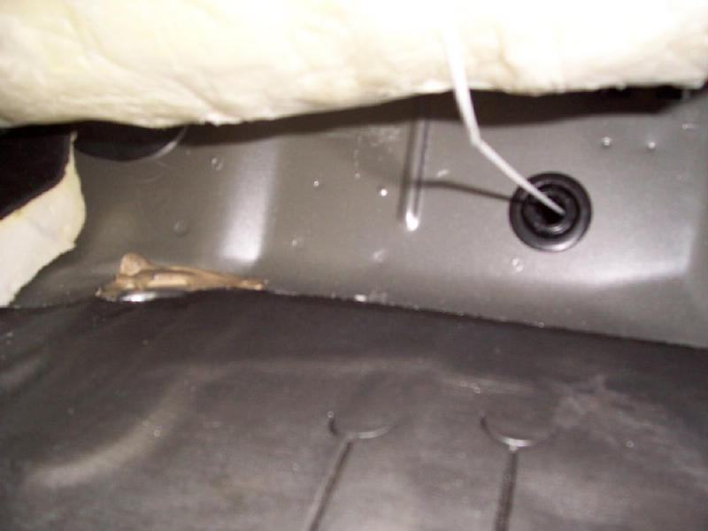

I'm trying to run my amp wire through the firewall and I can't seem to see where it comes out. Can you tell me if I feeding it through the right whole? Can somebody also tell me where it will be coming out in the engine bay? Thanks

I can't tell what that is. I ran mine from the outside in because it's easier. Just push a coathanger through first, then chase it back with the wire.

do it on the passenger side where the cluster of wires goes thru the firewall, use a 12" long straight piece of coathanger and tie a wire to it like half way and just push it thru, it's easy
I go from the inside of the car out

Thanks guys, got the wire through and I'm trying to finish up what I can tonight but its getting cold up here in NY. Besides, etronics.com messed up and didnt ship my headunit out yet... glad i payed extra $45 for overnight shipping 3 days ago
