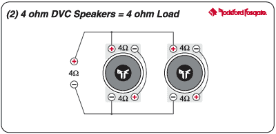

That amp is wired way too low, it's seeing .5 in mono when it should be seeing no less than 4. You are lucky going into protection is the worst that happened.
You need to rewire your subs (no alternative) to 4 ohm mono to get the most power out of your amp. You could also wire it to 2 ohm stereo, but according to the specs provided, you will get 33% more power this way.
Attached is a diagram of how they should be wired.
Let me know if you want to know anything else

see thats the thing. i havent a clue what an ohm is.
i set it up like your diagram this morning, works fine, it just doesnt seem as loud.
