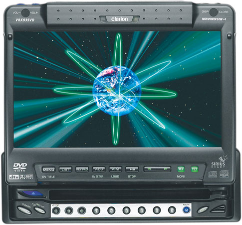

Here is the DECK I put in my 2k3:
Clarion ProAudio VRX935VD
DVD/CD/MP3 Receiver with 7" Color LCD Monitor

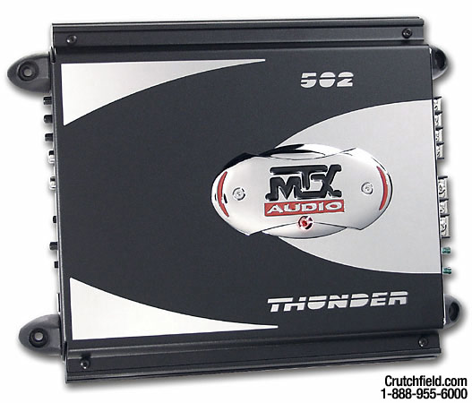

Yo
My 2 Channel Amp pushing my 2 JL Audio W6's, Series 1 ( the best series of 12's JL Audio has ever made!)
MTX Thunder502
125W x 2 Car Amplifier
Name:	2 channel amp.jpg

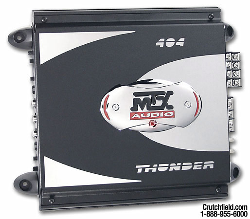

yo
My 4 Channel Amp pushing my Highs and Mids:
MTX Thunder404
50W x 4 Car Amplifier
Name:	4 channel amp.jpg

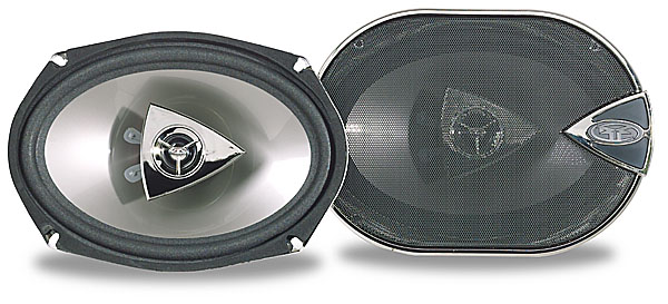

yo
I put these Rear Speakers (6x9) in. They are so crisp. Especially with those MTX Amps, those amps own man,so clean, crisp, and LOUD!.
Rockford Fosgate FRC4269
6"x9" 2-way Speakers
Name:	rear speakers.jpg
