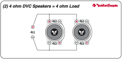

you can seal it up like you described, just make sure the sealed airspace is correct. ported boxes are usually larger than sealed boxes.
because you have two dual 4 ohm subs you can wire them for a 4 ohm load or a one ohm load....most amps cant take 1 ohm loads so here is how you would wire it for 4 ohms. you will need to look for an amp that will put out the rms power that the subs can handle at 4 ohm x 1

ok...i got it. Thanks for the pic.

wait; one question; Am I supposed to connect the + and - terminals that I'm not using? THat's what it looks like in the pic, but I want to make sure.

Yes, connect the other two that you are not using. A one channel amp can see a 4 ohm load, use all VC, if wired like above.

ok. I just visited the local audio shop, and got the low-down on how to hook it up. I have dual 4-ohm coils, so I hook (on each sub) the + of one coil to the - of the other. this makes it one coil, thus doubling the impedence, to 8 ohms. Then I get a 2-channel amp and bridge it. Hook up the + of the Left and - of the right. I connect the left to the positive on one sub, and then hook it up from that terminal to the remaining + on the other sub. Then I do the same with the - Right. This makes the 2 subs act as 1, thus halving the impedence, back to 4 ohm. Bheh. I would make a picture, but my Java is messed up so I can't post anything. The local place has a 400w-RMS Sony amp on sale for $200, and that is perfect (mine are 200w RMS each). I need to see if I have any monster cable left over from my home theater system though, cuz that stuff is damned expensive.
