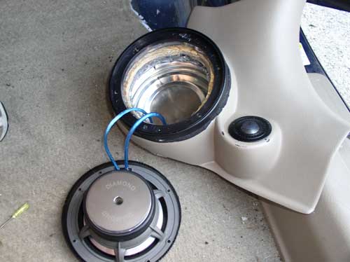

I am finally finished with my speaker install.... I can hardly believe it! First of all I would like to thank everyone who has helped with their posts, given ideas, suggestions, etc, etc. This wouldn't be finished or sound half as amazing if it wasn't for all of you! Definite thanks to mohawk, whiterabbit, regularjoe just to name a few... and props to my wife for thinking outside the box and coming up with this idea...
I wanted to post some pics and info on my q-form install. There is no way i'd be able to do a fiberglass enclosure to make sure these things were sealed, I have zero experience with that stuff and i wasn't going to take the time to learn... So my wife came up with a different idea... a coffee can... it sounds a bit crazy, but it is the PERFECT diameter for 6.5" components and for use with q-forms. I ended up using several layers of fatmat to strengthen them up and make sure they didn't resonate like crazy. As you can see in the pics below they ended up being around .5 cu.ft. (rough estimate) and sound AMAZING. I can put together a DIY if people are interested, I thought i'd try it first to make sure it acutally works and sounds good....
Feedback would definitely be appreciated... btw, the q-forms look like a$$ right now, they are very easy to chip up when cutting holes and doing like 5,000 test fits... anyone know where i can pick up some touch up paint?

here is what the inside looks like minus the speaker... not the prettiest, but you can't see it anyway...

and here's how it looks completely installed... the can makes the qform stick out a little more, but cutting back the carpet behind the qform takes care of it....

i would highly advise for you to spray the inside of the can with rubberized undercoating. the aluminum in the can is gonna resonate like you wouldnt believe

also, you might find that the seal you made for your kick limits your low end extension because of such a small enclosure...

Thanks for the feedback. I've actually checked out the resonating factor and all that, and it is fine. The can has two laters of fatmat and the qform does also, it is very solid. In regards to it being a small enclosure, I talked with a tech from Diamond before making the enclosure, he recommended the .5 cubic foot size.
The SQ is really amazing. Seriously. I cannot believe the difference. This install was completely done to make a difference in the SQ of the system. In regards to producing the midbass, it is great. My door speakers used to rattle like CRAZY when I would play certain songs, these are stable and I don't have any rattles. I'm a big techno fan and I have a few songs that have nice size frequency sweeps in them, they sound GREAT. You'd think a small aircraft was landing on my car... I also have a 12" sub in the trunk in a pretty small enclosure... around 1.1 cu.ft. I have the lp crossover set pretty high around 150hz and the hp crossover for the components set about 120 or so. it seems to be fine.
