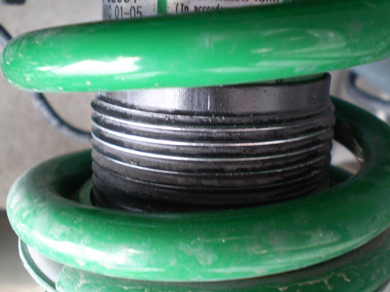

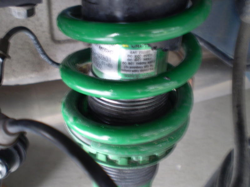

Ran into my first actual "problem" today, albeit a very minor issue.
The OEM dust sleeves in the rear are deforming, most likely due to colder weather rolling around. This is causing the dust covers to be a very tight fit around the coilover's threaded sleeve.
After hitting a nasty bump the other day, the dust cover has been getting chewed away by the threads and taking a bit of paint coating off of them as well.
I managed to do a quick fix by cutting away chunks of the dust cover with some tin snips, but I plan to cut them about 1" shorter next time I work on the suspension. Hopefully it will look much nicer after that... for now, this will work.
BEFORE ---v---------v AFTER ----------v
