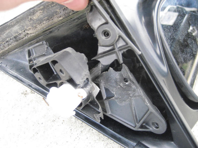

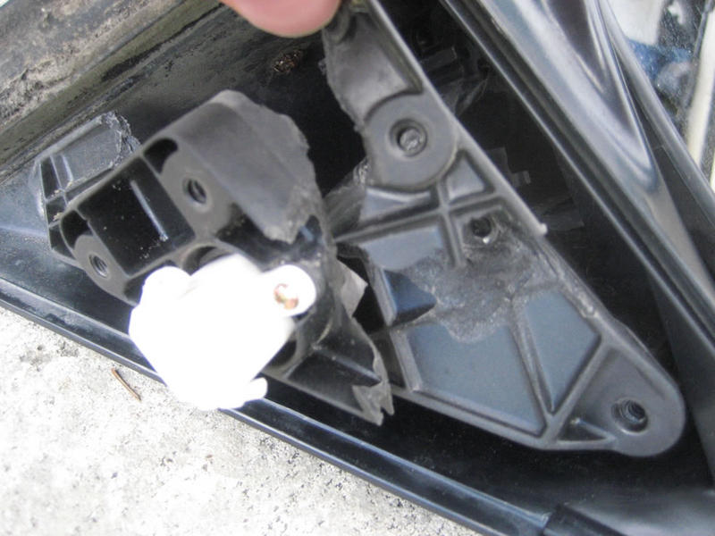

I had an unfortunately collision which left my side-mirror dangling from the drivers-door. I'd certainly rather repair it than buy a replacement if possible.
Here are a couple pics of the mirror, removed from the door. The pieces fit together like a perfect puzzle... I'm just wondering what I should use to do the bonding?
I'm looking for a permanent solution. Any suggestions or ideas would be appreciated. Thanks

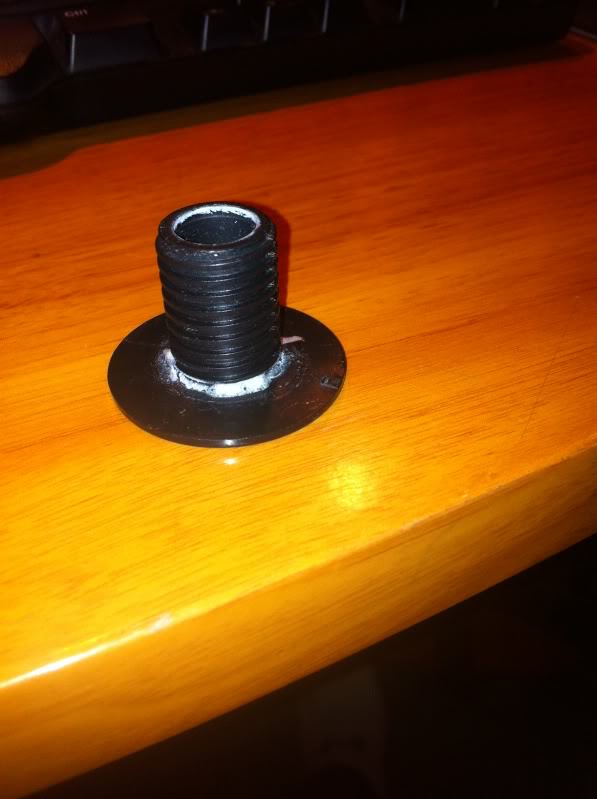

Sure, this example is from a piece of furniture, a shelf.. thing.. to be exact, but it's made of ABS plastic, much like your mirror. I accidentally snapped the threaded plastic off (and it snapped in a brittle fashion as opposed to a normal ductile plastic manner that deforms the plastic), and I used sumo glue to fix it, and the white foamy-ness is the excess glue that seeped out due to the glue's expansion.
The circular "bottom" base (really the top of the piece) is about 1.5" in diameter, and the threaded portion is about .5" in diameter, and where it made contact with the base is 1/16" to 1/8" thick (as the threaded portion is completely hollow). The whole thing is about 1" tall.
I put a small bit of the glue on, and balanced a 10lb weight on the top of it to clamp the 2 pieces together. The foamed up glue seeping out from the seam doesn't interfere with the functionality of the threads.
Like I said, you just gotta make sure you clamp the pieces together hella tight.
