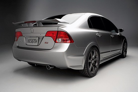

does anyone have a clue where i can purchase this? or how this was made? is it possible to get the parts to try n duplicate this??

just looks like a raised oem 8th gen civic spoiver to me. wouldn't be that hard to do. i was thinking of raising my spoiler on my 7thgen. i can't imagine it'd be much harder then the 7th gen. all you'd have to do is unbolt the stock spoiler, 4 10mm bolts (might be different size for an 8th gen) inside the trunk. then there's the electrical wiring to the spoiler lights on one side of the spoiler going up the leg. you'd have to cut the wires and fit some custum fabricated spacers with paint, then solder the wires together and insolate and rebolt. obliously you'll have some issues bolting it if you want the spacers to be tubes and you'd have to engineer something. i was thinking of using an open spacer. so it'd be like a squared "c" shape to make bolting easier. there's also a rubber piece to keep water out, but it'd be easy to find some thin rubber sheets to use when modding.
now it's going to be much more difficult if you want it to be mounted in the same place as the picture. you'd have to make a whole in the spoiler for the wires to drop down. then a matching whole in your trunk hatch. then you'd have to fill in the holes where it was mounted and paint them.

This was a concept SI so I doubt that they sell it. You can easily make it though. All it is is a raised SI spoiler that has the part in the middle.

Thanks a lot guys yea i kinda figured its a raised si spoiler. But it looks like the spoiler for a 2dr no?? cuz the ends on a four door spoiler are different than a 2dr right? or mayb its just me being wrong lol yea i really liked this spoiler put on that way imma c wat i can do Thanks!

pro civic probably has one like that
