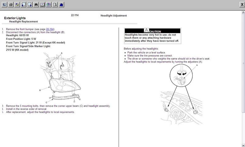

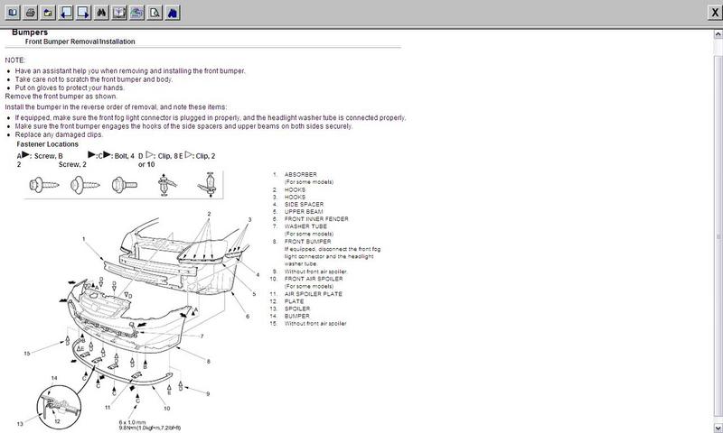

hope this can help!
ID:	77569   Click image for larger version

yeah bumper comes off, there are clips holding the upper grill molding to the car, a couple screws in the wheel well for the sides, and a bunch of clips on the bottom. then you yank the bumper off so it detatches from the clips. once off, there are four bolts holding the headlamp to the car.
