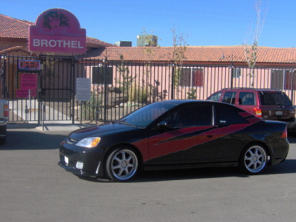

I have the BC2 front and rear bumpers on my Civic. The front fit fine with just some minor trimming of the bumper, but the rear required the left side to be v-cut and built up with duraglass to fit the contour of the left quarter panel.
I suggest when putting it on using automotive grade fasteners where attatching, and installing side stiffeners ( a piece of metal that attatches to the car body and the bottom of the bumpers) to make the kit rigid and not flex and crack when going down the freeway at 70. Most guys skip this step and it starts to crack at the upper attatachment points.
PM me and I'll walk you through what I did to make the fit and finish as good as it is on mine.
