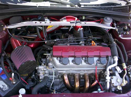

OBX is a cheaper alternative to those and it works the same... heres a pic of mine installed... only prob you'll have is the engine check being on, and the o2 sensor wires are a lil close to the header. It comes with a cat converter if you wanna put an EX catback on . So i think its an HP knockoff

OH yeah... DC doesnt make a header for the LX only for the EX unless u plan on putting on a EX catback

also the kamikazi is the only one that fits on an LX without any mods. You can get the DC header, but it won't fit right. It bolts up just fine but then it won't clear the sway bar. You would need an ex sway bar to be able to that.
