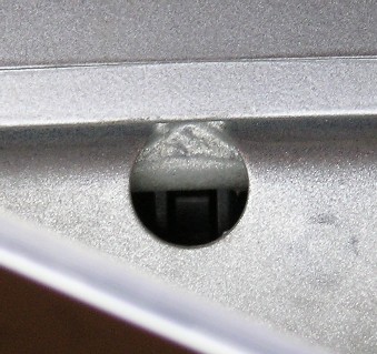

ive been tryin for liek an hour or longer to get this thing off.....i knwo it has 4 bolts and a clip in the middle but i cant seem to get it unclipped in the middle....as a matter of fact....i cant even find the clip...ive just been stickin a screwdriver back in that little hole haha........how do i do it??

Tooks some pics for ya.
Step 1: Get a flashlight. lol
Push that little tab with the screwdriver and pull on the trim piece. You have to pull toward the front of the hood.

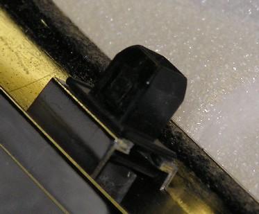

A pic of the snap piece on my old chrome trim (sorry for the crappy pic quality):
