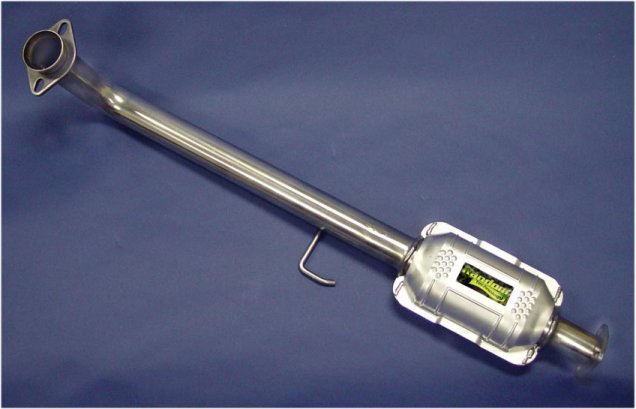

random tech. ex cat.

ok im just stupid .....im beginning to see what it looks like (do i have to move the front strut bar?)
ok i know greddy evo cat-back is legal
kamekazi is NOT (if u guys know any legal brand name header...plz name some) DC is, it just sux
is the random technology high flow cat legal?
Old Oct 29, 2003

Yup you have to remove the front sway bar i had to i thought if you could move the cat down a little the sway bar would clear but it doesnt you have to buy one for a ex good excuse to buy aftermarkte one
