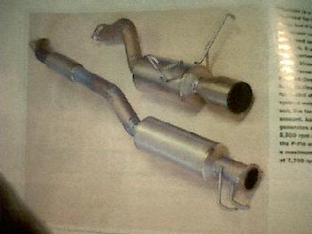

I just found the neuspeed system in my superstreet mag
"Titanium is a mterial that was once reserved for high-budget racing applications, but it has now filtered down to the passenger car market. The exterior of the neuspeed system is made entirely of titanium 60mm tubing, a center resonator, and end muffler, and an 80mm exhaust tip. The interior of the resonator and muffler feature a straight-through perforated core wrapped in stainless steel and fiberglass weave for sound absorbtion. The entire after-cat-back system weighs 15lbs. In comparison, the factory system weighs twice that amount. Adding the Neuspeed Ti exhaust generates an additional gain of 5hp at 5,500 rpm and 7hp at 7,700 rpm. With the P-flo and exhaust working together, a maximum gain of 11 whp at 7,700 rpm should be achieved. (this is for an article for an rsx-s)
