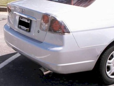

just for comparison
sedan rear bumper
Old Oct 15, 2003
XxSoVeReiGNxX's Avatar
Posts: 4,767
From: NJ
Rep Power: 335
As you can see, the sedan has a shorter, more compressed rear end. Hence, the sedan's flat butt.
