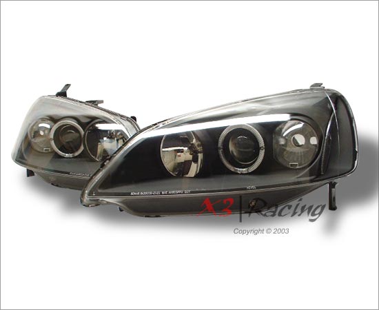

Does anyone have the X3 projectors?
If so I installed my brothers yesterday and they are both pointed down.
Has anyone had to aim the projectors? If so can you give a brutha help

They are the black housing halo projectors..
Can be found on X3racing.com
i remember when i was installing them there was a visable adjustment for the high beam
but none for the projector itself. My brother called me up today and said he couldn't see anything last night because they were pointed down
just thought i'd ask and see if you guys adjusted any

there is two litte bars on the back. ihad to take my bumper off and the lights, and just turn the bars or the screws depending on which one you are aiming. its realy just trial and error homie get to work. it also sux cuz you gottado it at nite. to get the rite aim park 8 to 10 feet from a wall or flat surface..
also the really cool thing about these lights is that at the top of the beam is is a rainbow.if you can aim them right when driving people will
see that as you drive up. if yours doesn't have the rainbow just open them up and clean the lenz>>>>>>>>>>>>>>>>>>>>

Acid baby's got the idea. But I'm going to take a pic for you
edit:
here
The two screw heads (circled in blue) are what you need to turn to aim the low beam

turn BOTH of them counter-clockwise to aim them up. turn BOTH of them clockwise to point them down more.
You can also point LEFT and RIGHT! Play around with the screws separately to get your desired left/right aim.
If you turn the right screw clockwise, the beam will point more to the right. If you turn the left screw clockwise the beam will move to the left.
