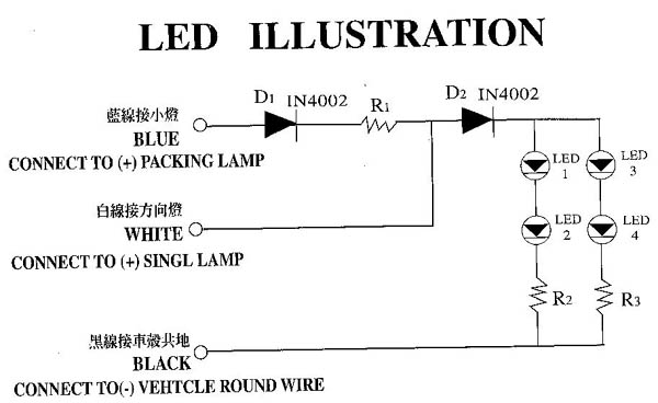

These are the directions that came with my m3 mirrors...

Is there anyone that can decipher these? Also, i dont know what to do with the wires it came with.
It came with its own little wire harness, with red, white, and black wires. I think Im supposed to splice those into the existing harness, because the fit is not universal. Which wires do I splice into?

packing lamp = Parking light
singl lamp = signal light
Vehtce Round wire = Vehicle Ground Wire
the triangle with the line is a diode, the squiglily line is a resistor, the TRiangle with the line in a circle is a LED (Light Emiting Diode)

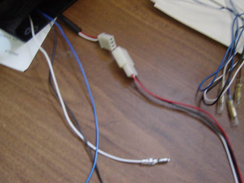

heres a close up of the wire harness

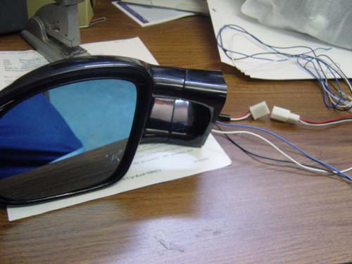

heres another shot

last one

Now, I guess my question is, how do I hook up those red, black, and white wires in the harness?

I'm gussing that they're power mirrors, which is what the red/white/black harness is for. The blue and white go to the parking/turn signal wires. The black just needs to be grounded somewhere.

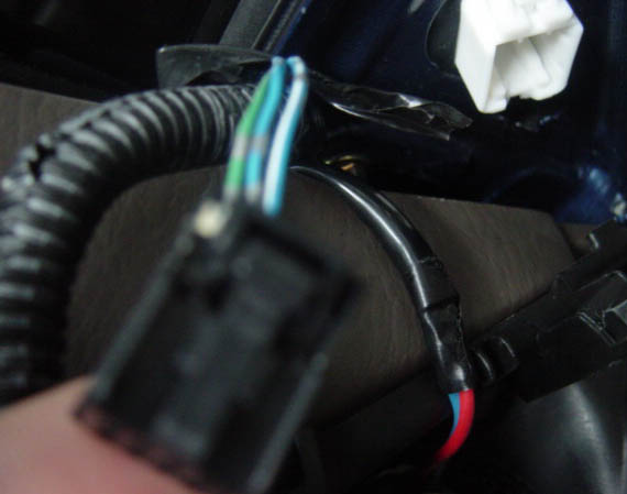

Ok, got the pics...
Old Aug 14, 2003
gotti's Avatar
Posts: 9,353
From: Pittsburgh
Rep Power: 381
Heres another...
So the harness will definitely not fit what they provided. So I think I am going to have to splice.
There are 3 wires, green, blue, and blue with a white stripe. I just need to figure out which one to tap into to.
