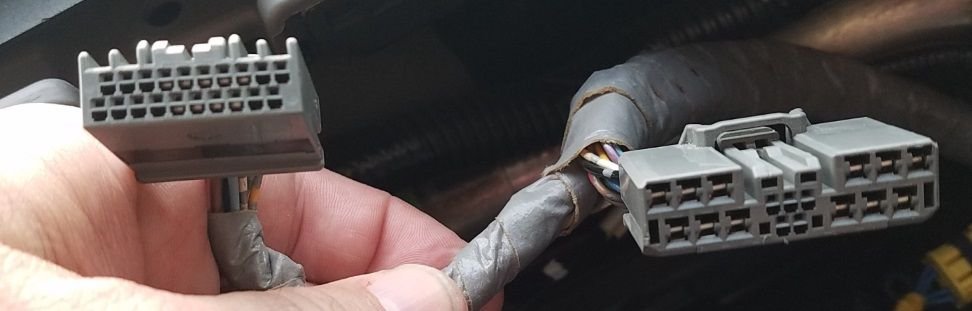

(My question is regarding an aftermarket head and not an original stereo unit. If this is in appropriate or the wrong thread, please let me know and I'll remove it.)
Hello. I recently bit the bullet and bought my first Android audio head, an SWM 8802 with Android 7.1. I bought it for use in my '07 Honda Civic EX which had a standard stereo and CD player, and no navigation. I purchased a harness extension for it (Scosche HA10B) so I wouldn't have to cut the original wires, but was not expecting to purchase an antenna adapter (which should arrive soon from eBay). My current trouble is that there's no audio.
The Android unit, like other's I've comparison-shopped, has two block connections to the back of the unit: an 8-pin block for the front/rear/left/right audio positive and negative, and another 8-pin block for power and everything else. One of those is a blue wire (looks more teal) that is shown as Power antenna/Factory amplifier/remote turn on. I simply connected this to the blue wire on the Civic Harness I got which matches up almost all colors. After a few failed attempts to boot the unit I used a continuity tester to find faults and fix them (all connections are closed circuit), but I still cannot hear audio. Does that blue wire act as a multi-function for the Power antenna, and the amp, and the remote turn on, or are those slashes designated to mean OR rather than AND where it will do one of those three things?
This is an image from a similar Android car head and shows the blue wire going to the antenna. Again, if it's the antenna, why is there no audio? It also say s"Amp Turn-on", but is there a hidden amp I'm not aware of? Doesn't the head provide enough amplification?
The antenna adapter that I purchased from eBay has a female socket for the plastic connector, and also has a blue wire. I assume this goes to the blue wire to the android unit and to the Civic harness, and is this most likely the fix to my lack of audio issue? I figured without the antenna I would still be able to hear audio through the built in speakers using the connected wires. There are mp3 files built in to the unit such as test sounds and The Price is Right music (which I'm eager to hear so I can make it feel like I won my car in the showcase showdown). But even as I play these there is no audio.
This is my first ever car stereo swap/upgrade so I feel pretty accomplished but would like to know if it's a stupid mistake I'm making or something I'm not doing. I was going to post this on xda-developers.com, but figured they're more into the software side than the hardware side regarding audio. I do have a few questions as well being this is my first car stereo upgrade:
1. The wires from the harness and the block connectors of the Android unit seem to be 23- or 24-gauge wire, so when I use a ratcheting crimping tool, the terminals are still loose. At first I had better results crimping at the very end, the flanged end that the cable goes into rather than the narrow end where the terminal contact is (spade/fork/ring/etc). But with the smaller wires there tends to be a lot of play. I was starting to solder the wire to the terminals but then thought, "I shouldn't have to do this as I'm actually crimping them instead." Is it worthwhile getting 25- or 26-gauge terminals or should I just stick with soldering? I went out and bought a huge 520-piece terminal set from Harbor Freight, but they end up having a lot of play to them when I crimp them as well. The ratcheting crimping tool was purchased from Harbor Freight as well.
2. Right now my connections from the Honda Civic harness I have an old terminal strip that I never used, bought it aeons ago when I had a '71 Chevelle but never used it. Would it be a better choice to put ring terminals on the wires and attach it to the terminal strip and mount it somewhere, or is it okay the way it is with a combination of screw-on caps and connecting terminals shielded by electrical tape? As I mentioned I used a continuity tester and everything checks out okay, but was slightly concerned for long-term use with heat and cold.

Yes, it is an EX Coupe. I read on the Crutchfield page for my Honda (https://www.crutchfield.com/learn/20...nda-civic.html) that there may be tweeters in the dash too, but I don't know if mine has it (and I can find my car sticker that listed all the options). You answer may be a lifesaver. Now carefully re-reading the steps I see this:
In coupes, you’ll find the amp beneath the center console, in front of the gear shifter. In this case, you’ll need to disassemble the console to get the wires to the amp, a process that is explained fully in your Crutchfield MasterSheet.In either case, you unplug the speaker connector from the amplifier and plug it into the connector on the bypass harness. This removes the factory amplifier from the system, letting you safely power your speakers with the new in-dash receiver.
I got so far before when replacing the shift boot but had difficulties removing the whole console. I'll try again tonight or this week and follow up.
Now you did mention the blue connect wire. Is this the wire from the Scosche harness that needs to go to it, the wire from the Android head block, or all three (Wire from Scosche, Android block, and the one from the Antenna adapter with blue wire)?
Thank you so much! You're a lifesaver!

The stock amp is on the tunnel (floor hump) up closer to the gas pedal than the shifter. Above where the shifter cables go through the floor. Sitting on top of the airbag control unit.
You cannot run speaker level output from the radio into the amp. You have to run line level outs to the amp, Or bypass the amp with their jumper harness, but then you may lose use of the stock sub. (center speaker in rear shelf) IDK, I don't deal with aftermarket radios at work. Too many variables and hack installs.
It's the same blue wire. The blue one that is shown as going to the antenna in the pic in your first post.
(connects to Gray wire in cavity G3 of the stock dash harness radio connectors, that's the wire off to the side in the antenna connector)

Allright I received the Scosche SLC-4 and hooked it up as so:
From the Android SWM8022:
Audio block wires (left and right, 4 pairs) to SLC-4
Main wires to Terminal strip, to Scosche harness
L&R RCA Outputs to Aux part of Scosche Harness (I believe these are outputs from the Aux input Jack)
Antenna wire to antenna
Line output converter:
The inputs have the bare wires from the Android
RCA outputs are going to the RCA jacks of the Scosche HA13B
Scosche harness goes to connectors that lead to the original factory amp. One blue wires from the Aux harness connects to the blue wires on the terminal strip
I tried the built in sounds and the radio (now that the antenna is hooked up), but still nothing. I'm going to wire a home speaker right into one of the speaker wires and test to see if I get any sound at all. I need to know if it's a bad unit, or the amp isn't turned on. Any clue as to why I'm still not getting sound?
Last edited by emaxxx4; Aug 24, 2018 at 10:34 PM. Reason: Added tagline "4 pairs of two wires each"
Old Aug 24, 2018
Re: No Audio on Android SWM8802 Audio Head
You NEED 8 wires (4 matched pairs for 4 speakers) run through the line converter. 8 wires in from the radio, 8 wires out to the stock amplifier.
You don't know what the RCA outputs are for on the back of the radio? Leave them disconnected.
Been looking in a real wiring diagram for the car:
The RCA cables that come in the smaller (gray?) connector need to be connected to the AUX jacks on the back of the radio IF it is equipped (I can't read the labels in your picture). They are for using the AUX jack below the power outlet in the dash.
YOu do have a blue wire connected for the amp turn on AND the antenna booster?
