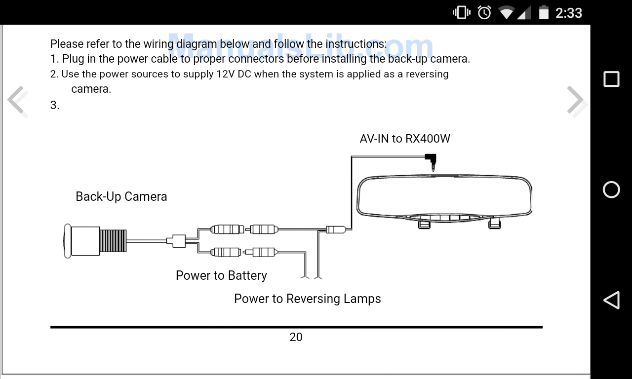

I think you might be right! I dug this up from the net (see diagram). It's from the owners manual.
Also, see this video -
Skip ahead to 1:19 and ignore what she says at 2:37.
I've seen this video and diagram before but they didn't make sense to me until you suggested wiring both triggers (one as power, one as a trigger).

Re: Aftermarket backup camera installation - 2014 LX sedan
At the cars' reverse bulb harness:
Brown is 12v+ (switched; only powered when the light is on)
Black is 12v-
So....
connect both red wires to brown (switched 12v+)
connect both black wires to black (constant ground (12v-))
only connect to one reverse light harness. No reason to string wires across the trunk to both.
When you run wire to the camera in the trunk lid (assuming you place it near the license lights), leave a long loop at the hinge area to reduce stress from flexing every time you open the trunk. When I did my backup cam the first time I followed the stock harness and release cable but the wires in the camera harness broke from flexing after just a couple years. Now I repaired it and gave it a lot of slack in that area.
