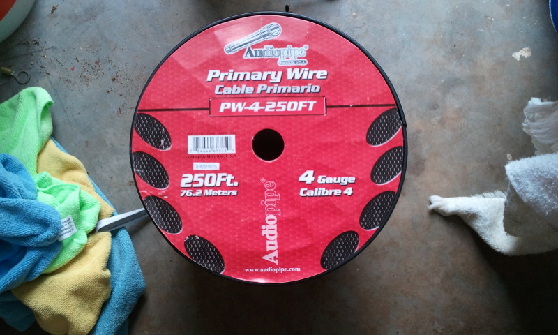

You've got your information wrong. My kits are made of 4ga audio power cable.
Old May 27, 2012
  #33
2009civic's Avatar
Joined: May 2012
Posts: 46
From: Melbourne, FL
2009civic is an unknown quantity at this point
Re: How much for upgraded electrical system
What brand wire is it? Is it OFC or CCA?
OFC
http://www.audiopipe.com/products/ca...ps-cables.html
Meh, AP is junk.
Now if you want real wire, http://www.knukonceptz.com/
