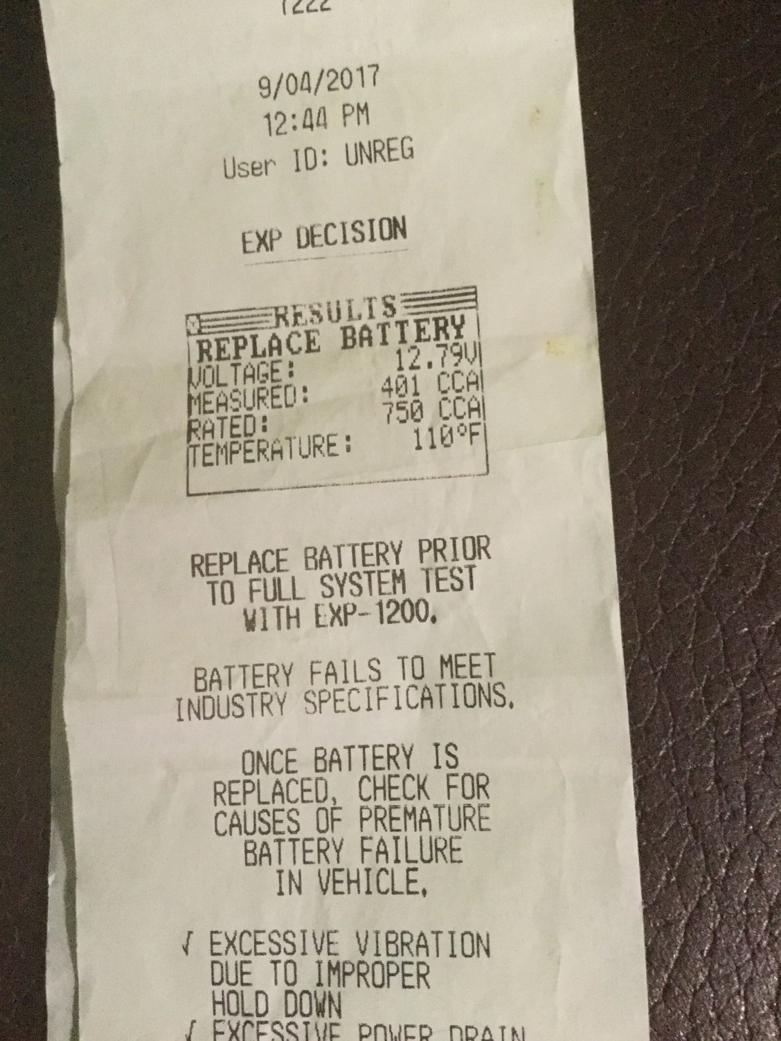

Hi I have a Honda Civic 2010 Sedan LX.
My car mechanic says my car is running good no problems but when I go to Pepboys or Advanced Auto Parts they claim my battery is faulty. Should I replace my battery? I get car battery signals frequently on my dash.
Results of Car Battery Analysis:
Voltage: 12.79v
Measured: 401 CCA
Rated: 750 CCA
Temp: 110 F
Thanks in Advanced.

The test would be a fail.....based only on the claimed 750CCA rating.
But why do you have a battery with such a large CCA installed? Wait....no...
IS YOUR BATTERY REALLY RATED AT 750 CCA????? Open the hood and read the labels on your battery.
The original factory installed battery (blue sticker?) was only rated at 310 CCA, and Hondas replacements are 500CCA.

Yes my battery is actually 750 CCA. Just to let you know I don’t know anything about batteries my mechanic did this all for me. Is having a really big battery a good thing or bad thing? Also that’s the since I see occasionally coming up on the dash. I got it from a 3rd Party Autoshop as well?

Ok so we know the battery fails its test but still starts the car okay for now.
