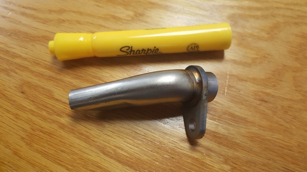

My kid and I took the head off his 08 civic 1.8L for a blown head gasket before I went on vacation. After being gone a month and receiving the head back from the machine shop we installed the head.
Here's the dumbaXX part. For the life of me I can't figure out where the EGR tube goes. (thats what ebay calls it) It's about 4 inches long, round at one end and ovel at the other with a slight bend.

That needed to be bolted on before the intake manifold went on.

Luckely I hadn't bolted up the intake.
Just installed the tube.
