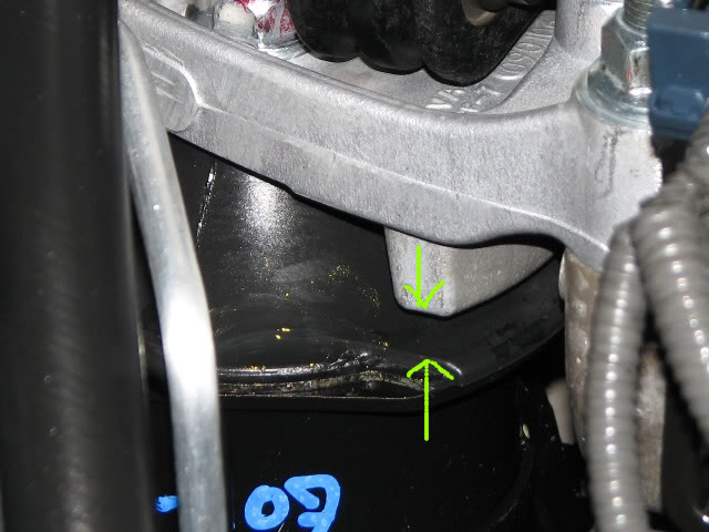

Ok...how about this angle
Check if engine mount on passengers side has collapsed or come apart.
Collapsed is much easier to see than 'came apart'
Collapsed, check the pictures in this post: https://www.civicforums.com/forums/1...ml#post4577741
(Peruse the whole thread to see what most people complain of when this mount collapses too)
Pics:
Bad
Bad:
New replacement has a significant gap:
To see if it's come apart, you'd need to remove the torque rod from the top of that mount then jack up the engine a little to see if the center (threaded insert) has ripped free of the main section of the rubber in the mount.
End result:

Thanks ezone. Yeah I could feel the vibration on the door when it was jacked up and wheels off.
I did see that thread after I checked everything and I guess I didn't think that was a possibility, I originally was looking at that dogbone and didn't notice any vibration so didn't think anything of it. I didn't realize at the time about the mount under it. I also saw that most people say that it vibrates in reverse and when shifting which is not happening to me.
I did go and check the spacing after realizing there is supposed to be about 1cm gap in there. I have I think about a 1/4" which may indicate it is starting to go? I ordered one from the Honda dealer and will be picking it up today. Don't know if I will get a chance to install it this weekend as it is supposed to rain on and off all weekend. I hope this is the problem.
I didn't find any torque specs for the bolts on the top bracket that attaches to the engine, I have a Haynes manual which usually has the specs but nothing for the mounts. I guess a 1/4 turn before it snaps off? Just kidding!
I will update after its in and if the vibration is gone.
Thanks for your help and time.

A 1/4" gap isn't a problem yet, but has the top center button separated from the rest of the mount like in the last couple pics?
Torque specs you could probably determine by the shaft diameter and thread pitch using general charts
I just glanced at info
14mm head = 36 ft lb
17mm head = 47 ft lb,
19mm head = 54 ft lb

Changed out the mount today. It looks about 1/8" more space than the old one. The old one was not separated at the top. Vibration is a little less than before but still there.
Once you hit 50mph you can start feeling the vibration in the passenger seat but not the steering wheel.
Could the sway bar bushings be worn causing the vibration?
Nothing looks to be worn just by doing a visual. I guess I will just have to replace things one at a time till I find the problem.
