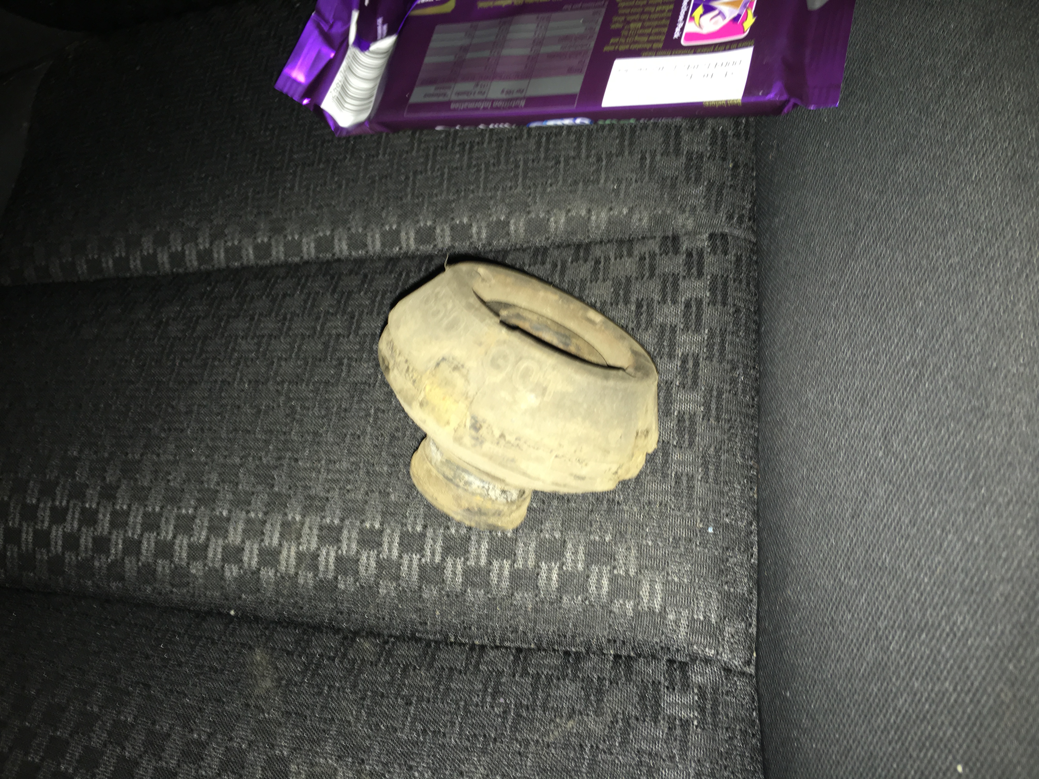

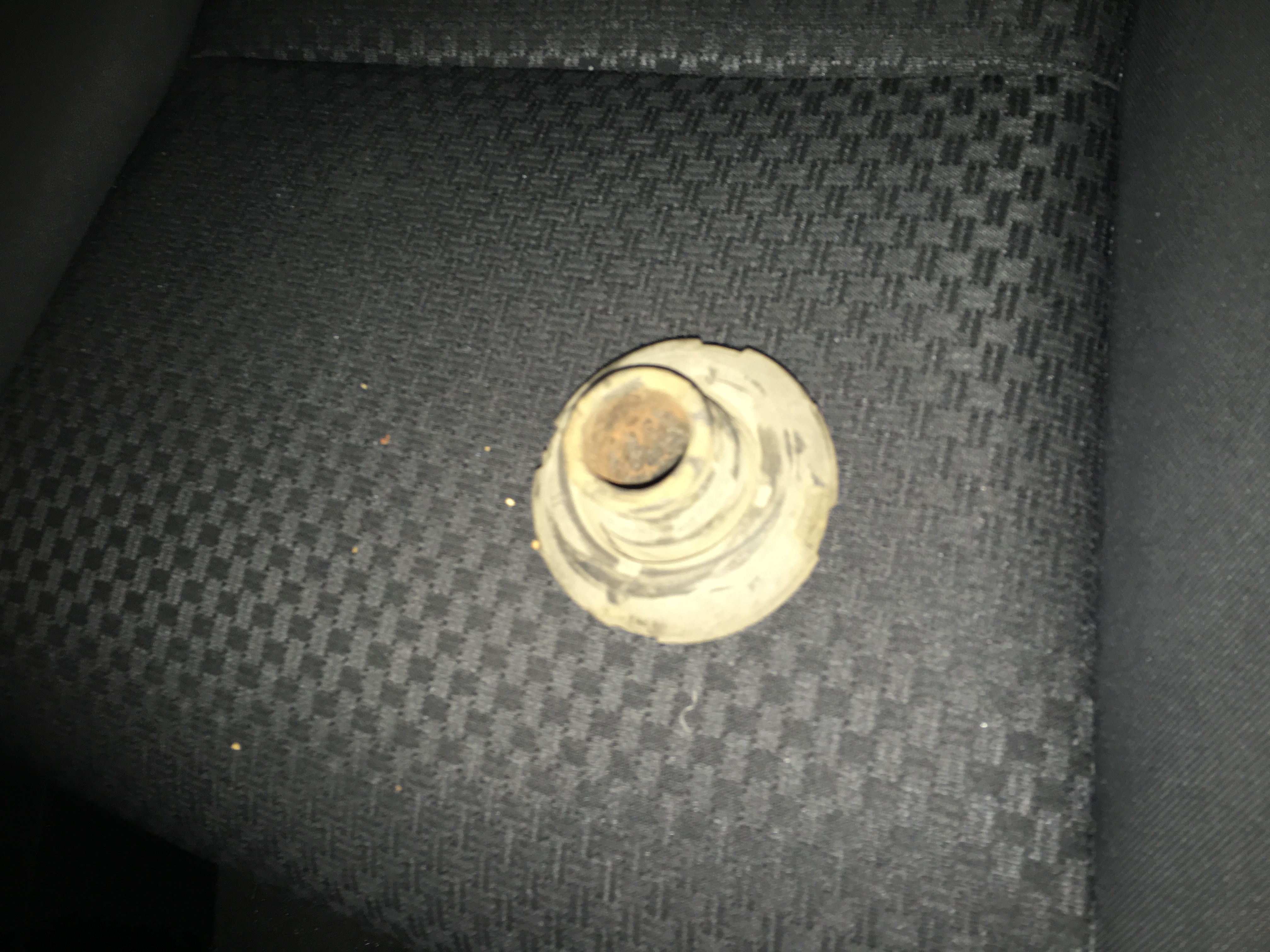

Hi all,
I was wondering if you could help me.
I went to move off and all of a sudden there was a noise of something breaking.
Now the car won't move.
It revs fine, goes in to gear but won't move. I can't stall the car either by lifting my foot off the clutch. Any ideas?

Your speedometer needle still shows a road speed when you try, even thought he car does not move.
Might have loud banging noises under the car.
Rubber donut is from one of the axles.
An axle has broken in half. Replace it. Inspect the opposite axle for similar, rust around the donut is a clue.
