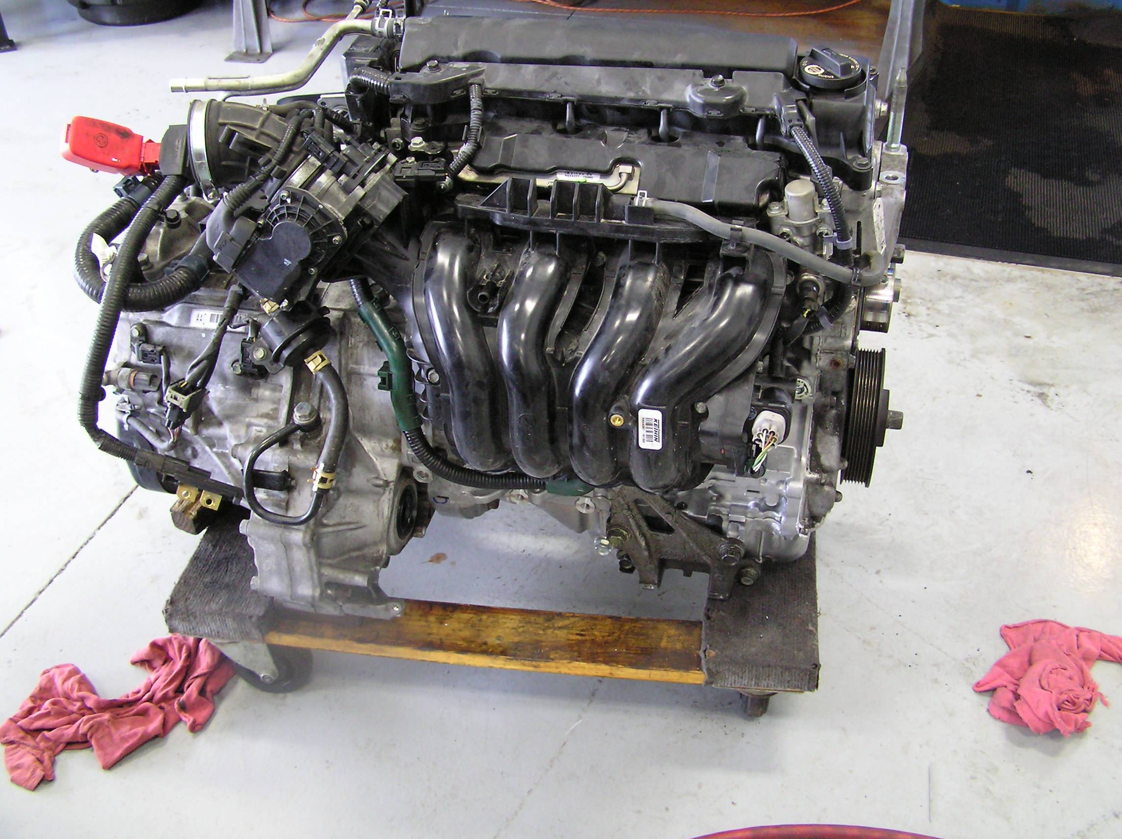

hmm the oil pressure switch is this plastic ? i noticed something near the power steering pump a black hose with a black plastic it looks like where the oil starts leaking from
my loss of oil is not bad i dont think im trying not to drive it but the sound of the tick scares me .... its not a knock its more of a ticking and as the RPMS go up the tick gets faster ... what does the vtec solenoid do ? i tested to see if i have vacume threw pvc changed it etc all good but i dunno ..... like what do u think honda will charge me just to diagnos the problem ? its really hard area to geto i can only see on phone recording ... or if i took the wheel off i might be able to get to it im trying to find specs on the internet of the motor but where the problem is i cant seem to find any pics
thanks so much for replying will be happy to hear from u
edit when im driving it sounds like a sewing machine
Old Dec 22, 2015
  #35
Rep Power: 518
Re: ~need help loud ticking coming from front end~
Size:  376.8 KBHere is a pic of the back of an R18 engine, steering pump not installed
hmm hard to tell
