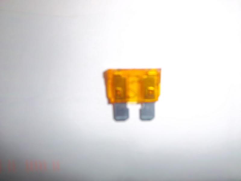

So it was the back up 7.5 fuse under the hood
