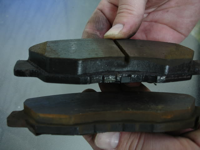

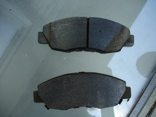

So, just for giggles tonight, I took apart the RF brake setup to troubleshoot a bit further (rubbing sound and clunk). (started noticing the occasional single 'clunk' today). Decided to back up through the install process and re-install, just to see what might happen. When I pulled the outside pad, it looked weird on the edges... here it is compared to the previous pad (new is on top):

Now.. since the original pad doesn't look like this, I'm guessing this isn't normal?
Causes? Suggestions? Ideas?

You didn't use any lube on the bolts your caliper slides on. This causes your caliper to bind when the piston pushes on the rotor. And that is why your pads are screwed. You need new pads and lube for your bolts and you'll be fine.

Actually, no, I didn't lube any bolts up..
New pads I can deal with, though.
Any DIY that shows how to do this bolt-lubing-thing?
Any recommendations on what lube to use?
Thanks for the answers!!
