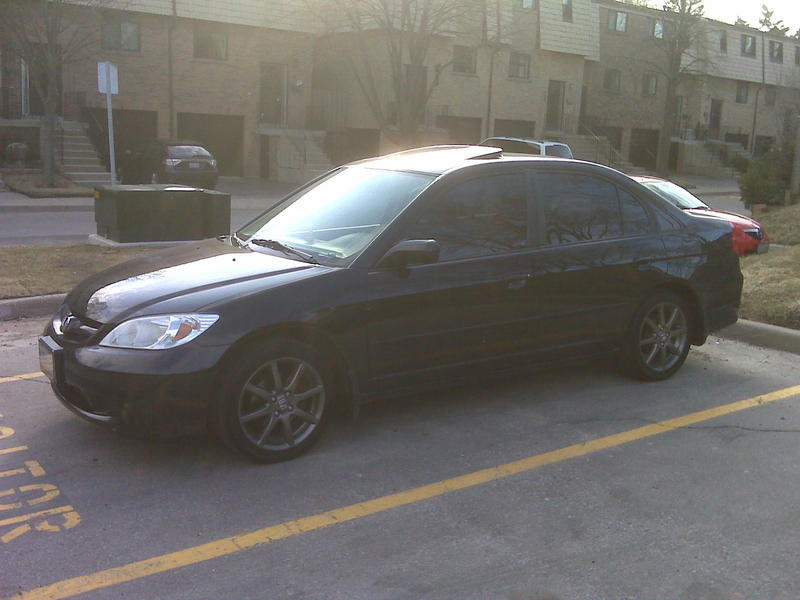

Well I did it on a 7th gen here out in Canada! Heres some pics. I put them on with out using spacers or longer studs. Just bolted up no problems. No rubbing or hitting the struts.
Do you not see this guys post? he is running them with no problems

Car looks great! I have the same rims and love the look. Just curious as to what size tires are you running? i have 205/45/16 but i'd like to go up to a 205/50/16 but i'm worried about rubbing. Is your car lowered?
