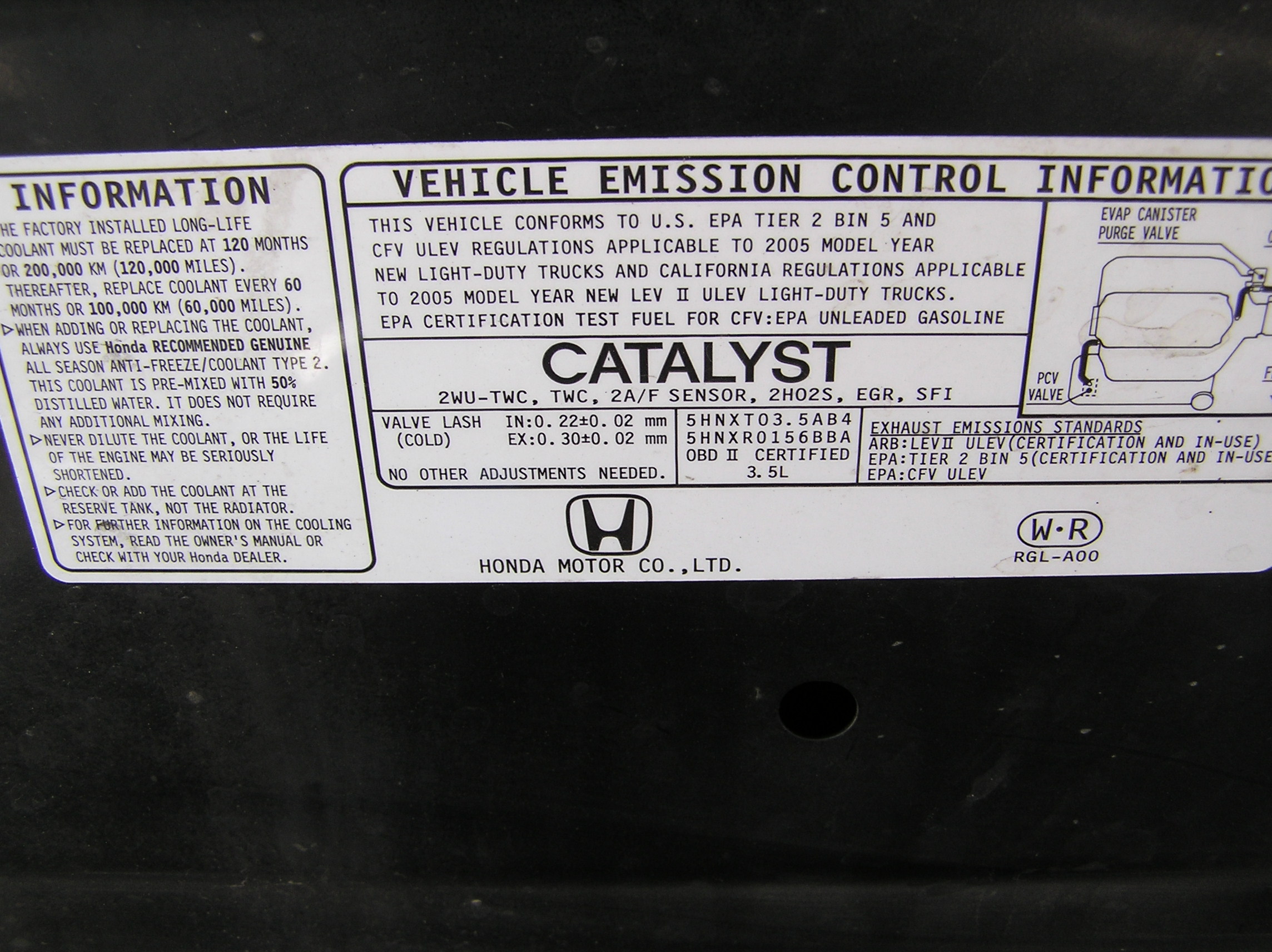

Emissions label somewhere in the engine compartment area or on the hood.
Here's an example from 05 Odyssey

Old Nov 19, 2014
Rep Power: 518
Re: California 2004 owners- is there a CA sticker?
If you read this one (this is a pic I took of a 49 state Van at work) it does state "AND CALIFORNIA REGULATIONS APPLICABLE TO 2005 MODEL YEAR" bla bla bla.....
Really need to see and read an actual label for a car like yours.
