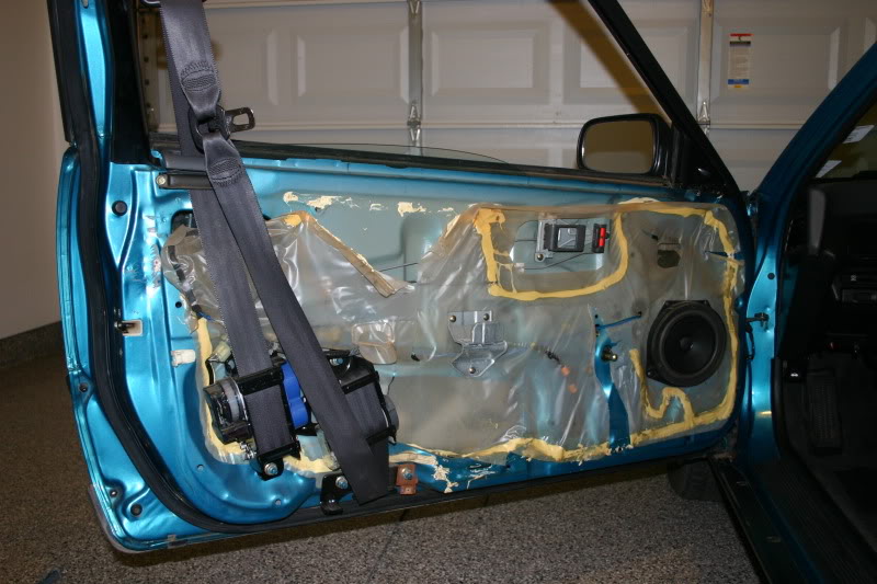

You get water inside this door, all water will stay out of the interior:

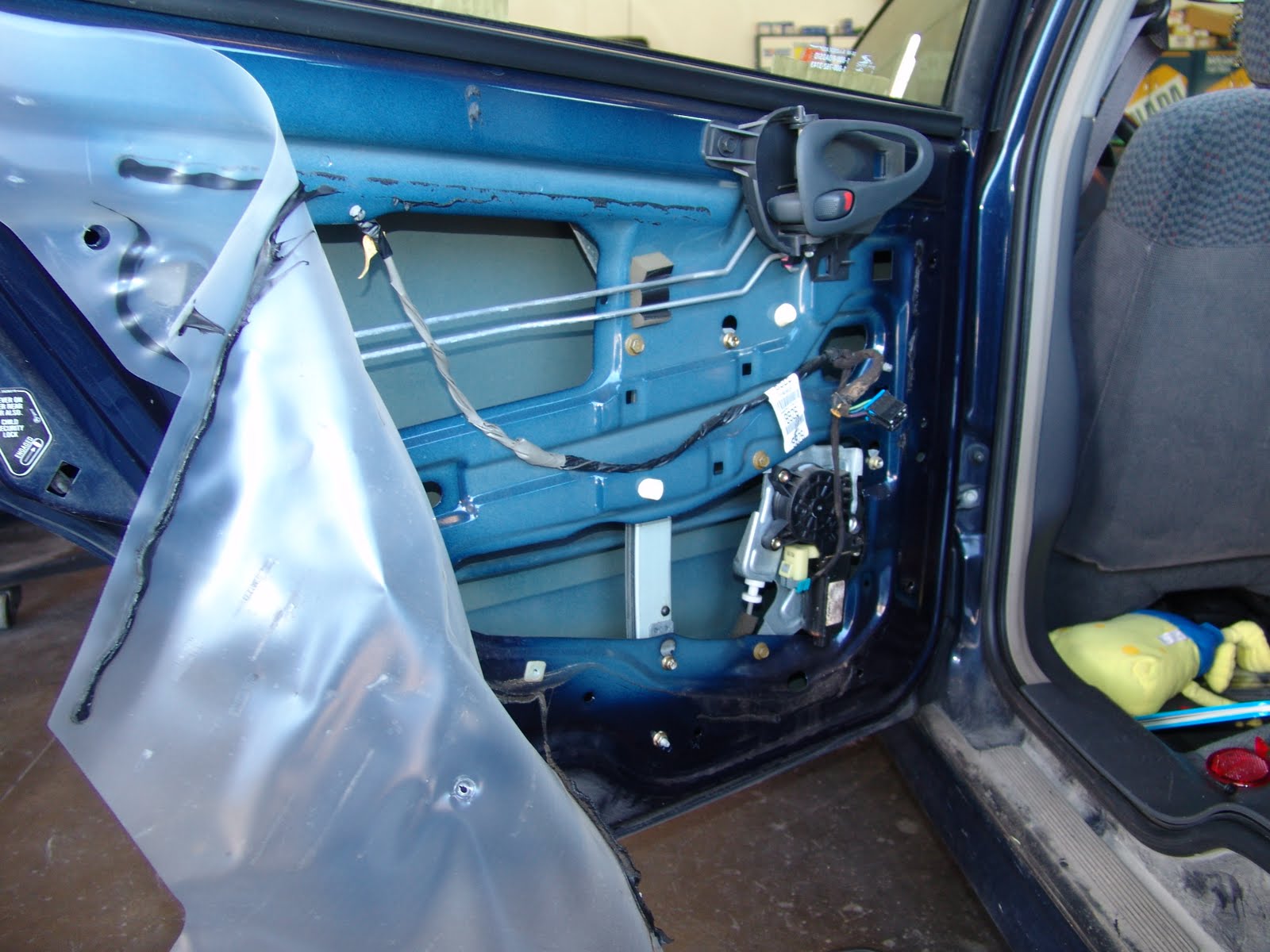

But if you get water inside THIS door, water is free to enter the interior because thee vapor barrier is pulled down and no longer covering the open spaces:
Is this making sense yet?
