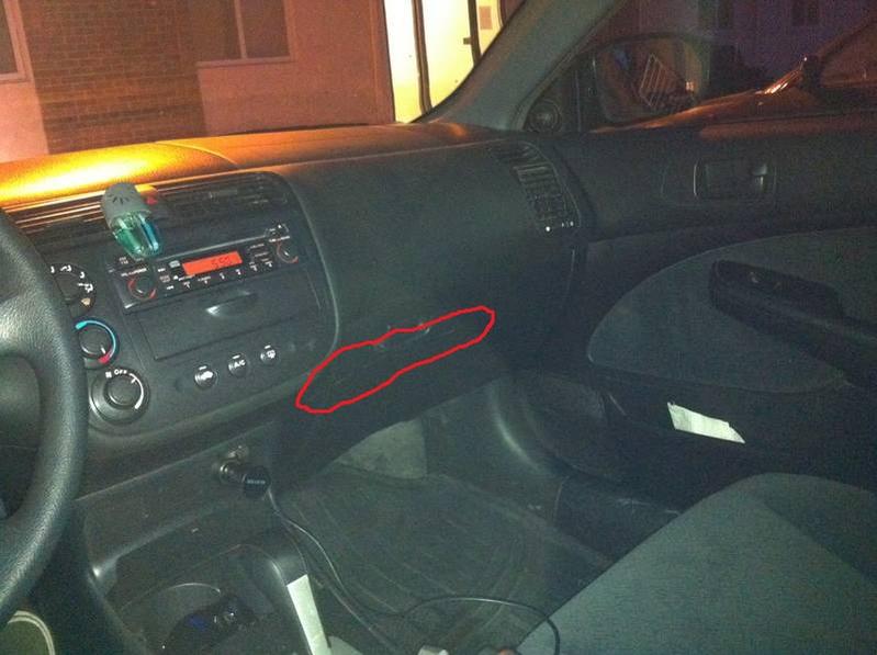

So on my glovebox it looks like someone took a knife to it and made a nice long line that extends close to my stereo. I have a picture of it... not the best quality but it will give you an idea of what im dealing with. Does anyone have any suggestions as what I can do to fix it? Thanks, I appreciate it!

Black dash?
Black touch-up.......

That's a tough one. Hard to see everything from the pic. For the glovebox, you can remove it an sand/fill/texture the affected area, then prep/paint the glovebox with a good interior plastic paint. Not sure of the durability. Some people have good results with no issues other encounter flaking (mostly due to poor prep). Or you can head to the junk yard and buy a glovebox. If it extends to the dash, then you may have to live with it or spot treat/paint. Good luck.
