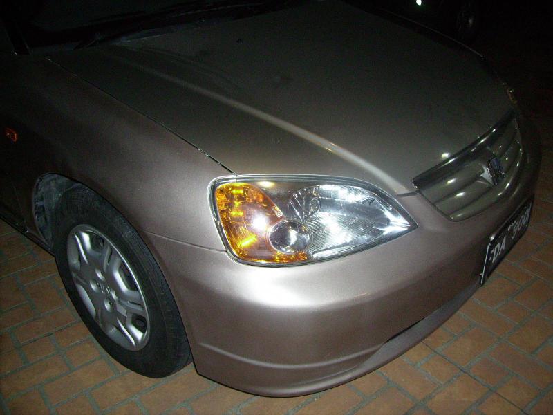

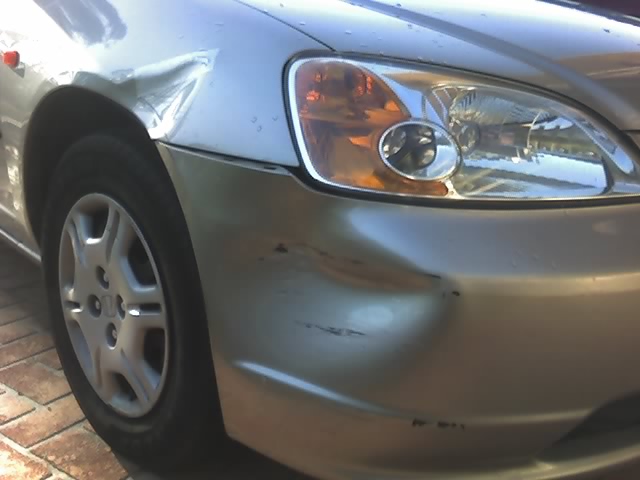

Hey! i have a little problem here, im in need of the original honda paint codes
as, i have just recently fixed and painted my front bumper but the paint matched by the shop here in 'Sydney' have either made it to dark, or have not matched it correctly, my cars paint code in the user manual is 'titanium' and the paint mixed by the shop has turned out more of a toyota camry kind of gold opposed to the light metallic colour my car originally has, or could this be due to fading?
any help?
ive also included a pic of the damage and the cars colour(compare the bonnet and bumper... oh and i am aware the car is a little dusty
thankyou very much! for all your help!
thanks!
any help?
).thankyou very much! for all your help!
thanks!

.. and yeh that titanium code is the same one under the hood, titanium metallic "YR-525M" but the stupid shop must of done something wrong as it was too dark..
i found another shop here in Aus who colour matched it by eye and everything for half the price!!
thanks once again for all your help! it is much appreciated!!
thankyou for all your effort
i found another shop here in Aus who colour matched it by eye and everything for half the price!!thanks once again for all your help! it is much appreciated!!
