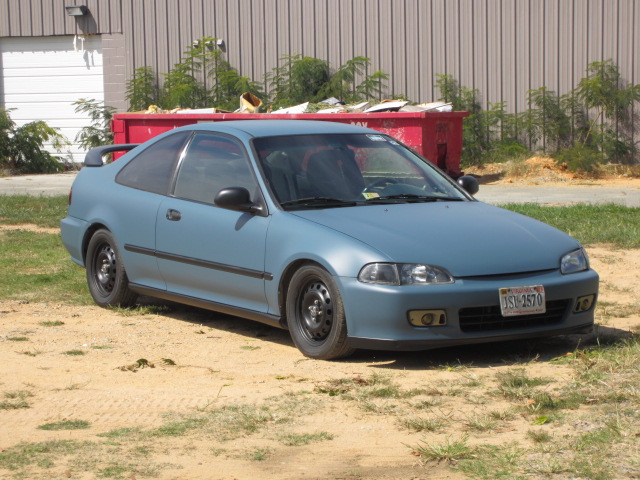

I don't know much about Honda swaps, but I've got a 94 coupe with 419K miles. It recently burnt an exhaust valve on #3, and there's a guy who'll sell me a D16Y8 head. Is this literally just a "plug and play"? Money is extremely tight, and I just need the car up and going again. Please let me know if this head will bolt on with no problems. Again, my current engine is just a D15B7, non-VTEC, 16 valve. Car is a 94 DX coupe, 5-speed, federal emissions.
