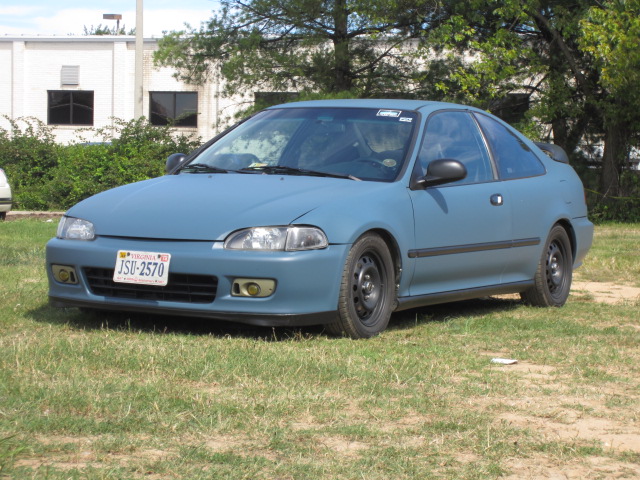

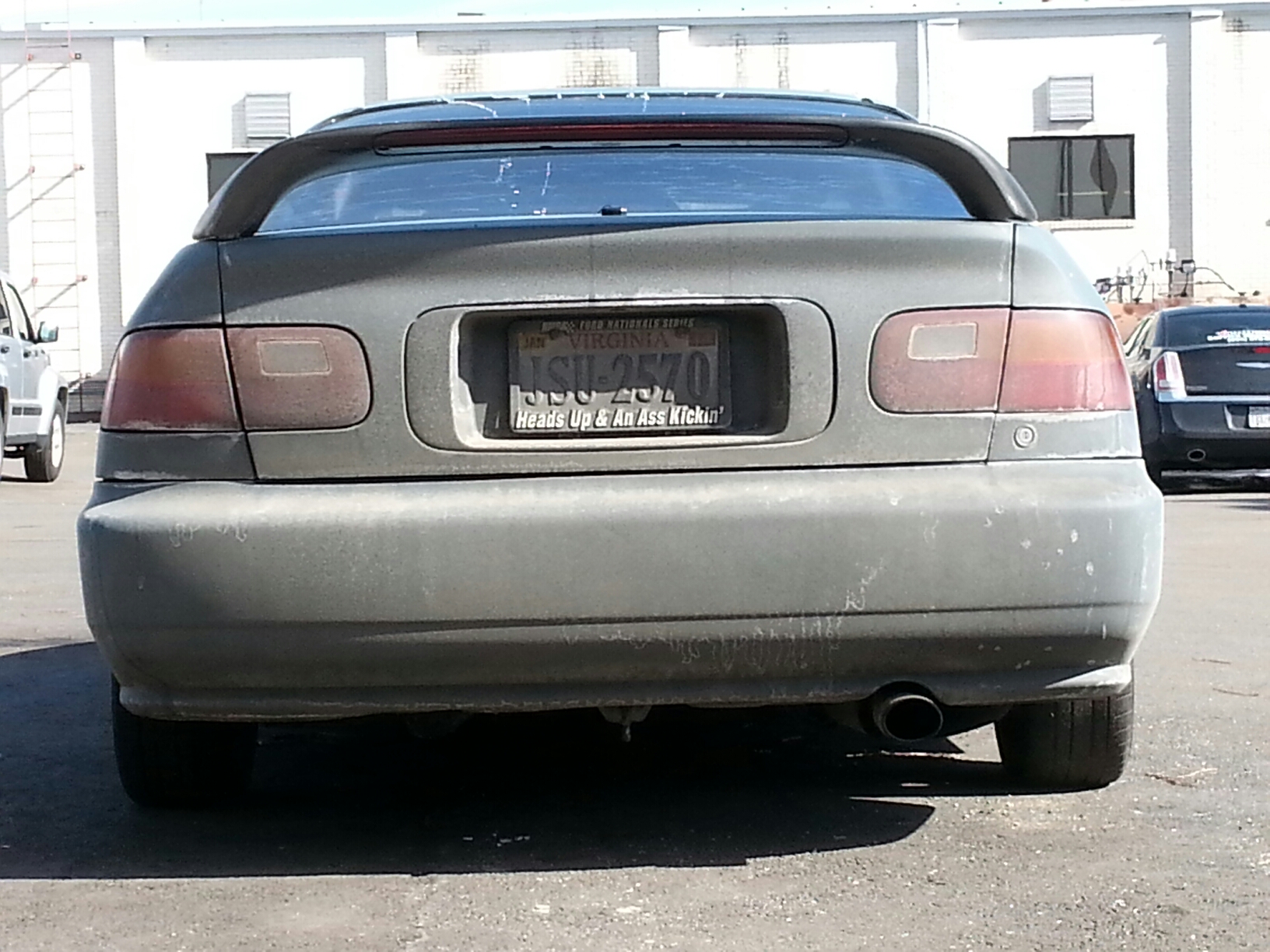

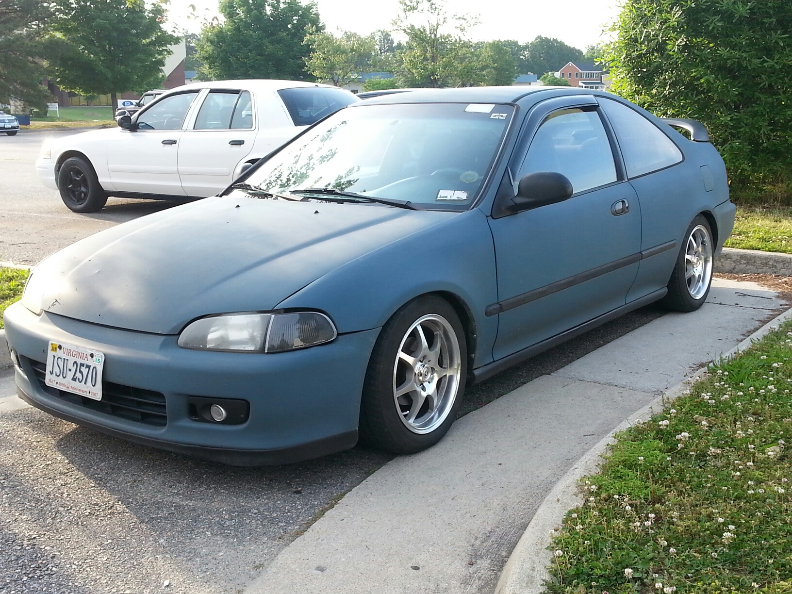

This is going to be a lengthy post, as I want to be very detailed.
I have a 94 DX coupe D15 SOHC 5-speed, and I've had it for about 11 years now. It had 222K miles when I bought it, and now it's sitting on 386K. From day 1 it's always smoked some when flooring it, and around 260K I was having a problem with it fouling out spark plugs every 2-3K miles. I know the original owner of the car, and it's always had Mobil 1 since new. I was still running that at the time, using 10w40 weight. A coworker and Honda guy recommended switching from synthetic back to conventional oil. I did, again using 10w40, and that got rid of the spark plug problem.
Fast forward to today, and I am having a rather significant oil burning issue. The car uses a quart of oil anywhere from 300 to 500 miles, depending on how much I have to flog it to get around traffic. I've been changing it every 2500 miles since I've had it, and I'm now using 15w40 diesel oil. I AM NOT VERY HARD ON THE CAR. Very seldom does the throttle ever get wide open, it's not a fast car, and I don't expect it to be. The car is obviously daily driven, and on my commute to work, I've been going an extra 5 miles out of my way so I can stay on the highway longer and bypass about 20 stoplights each way to and from work. I don't drive over 70mph so I can keep the rpm's under 3200 while cruising. Other than the oil issue, the car runs and drives great, it gets about 35mpg average, and has ice cold a/c. It hasn't lost any of the little power it originally had.
I enjoy this car, and plan on keeping for a very long time. I am a rather broke fella, so an engine swap is not really in the cards quite yet. I'd like to see if I could squeeze 500K out of this engine, but over the last year, I'm not so sure if it can take it, as I'm sure most of the oil is getting past the rings. It now smokes a little while normally accelerating from stops. As you can see from the last 2 pics, the back of the car stays stained with oil residue.
What I'm asking for advice on is, could I start running 20w50 in it? The area in which I live sees a temperature range as low as 10F, up to 95F. I'm just trying to get the smoking down some and see how far I can stretch the engine. It's been great, and hasn't ever been apart aside from routine gaskets, timing belt and water pumps, and a distributor a few years ago. Any advice would be appreciated, just please keep in mind my very low budget.
