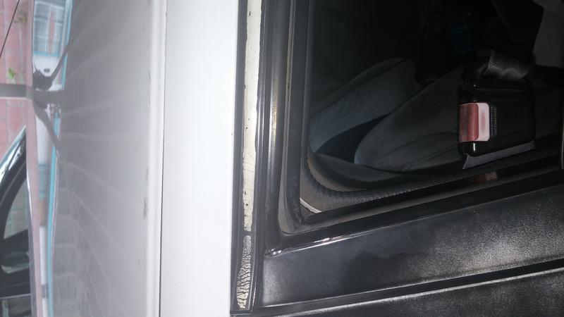

But I'm trying to figure out what the name of this part is, all that comes up is the plastic on the lower part of the window.
I'm not sure why it came out sideways, sorry. But the part I'm talking about is starting to peel.

The one on the outside, the horizontal moulding with half the black missing?
I think you want # 7/9, 9 is for the left front
Linky: http://www.hondaautomotiveparts.com/auto/jsp/mws/prddisplay.jsp?inputstate=5&catcgry1=CIVIC&catcgry 2=1991&catcgry3=4DR+LX&catcgry4=KA4AT&catcgry5=SID E+PROTECTOR
NOTE: DX has a different part number from EX and LX so start at the beginning (www.hondaautomotiveparts.com) and look up your own car.
EDIT: Catalog says this one I looked up is discontinued. Good luck searching.

The part I'm looking for I believe might be #8. It's a rubber seal. The part with half black half white is part of the door I believe. But thanks! I'll look for it on the site
